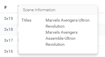

I’m currently running v2.0.0.4326 and the only aliases listed for “Marvel’s Avengers Assemble” are:
- Avengers Assemble
- Marvels Avengers Assemble
Yet, according to The Submissions linked at the top, Marvels Avengers-Ultron Revolution was “already added” as far back as March:
3/18/2016 6:14:47 | 264030 | Marvels Avengers-Ultron Revolution | Marvel's Avengers Assemble | Already added
As a follow-up, I’ve also seen it listed as “Avengers Ultron Revolution”, should that be added to the list separately?
It’s an alias for season 3, not the full series so it will only show when you hover over an episode in season 3.
Yes.
Thanks Markus. I don’t see the alias when hovering over Season 3 episodes, but Sonarr did seem to grab the most recent episode so, I guess it is working.
Thanks. Apparently, I’m a little slow. That totally works.
