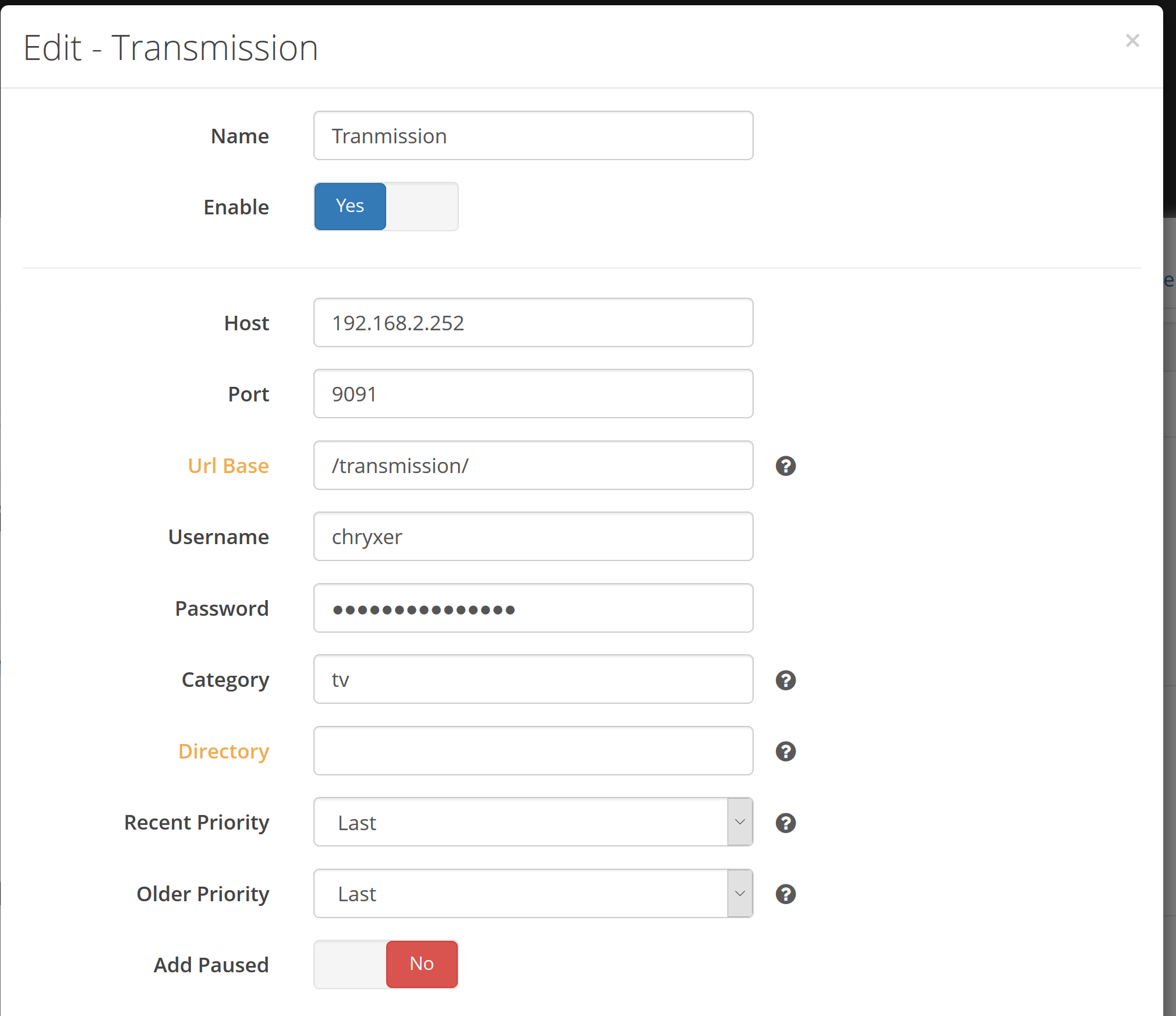

I’m running Sonarr in a docker on my synology NAS. I am new to this so i have no idea how to configure sonarr correctly in docker. I have watching countless videos and reading similar problems on the internet but i just can’t seem to figure it out. Hence i’m looking for help on the forums now.
I am able to find series on sonarr and add them to transmission so they get downloaded. Sonarr will not rename the download however. The download is moved to the downloads/tranmsissionvpn/completed/sonarr folder but it is not renamed (i have ofcourse enabled this in the options of sonarr)
The PGID and PUID is set to the correct user with the correct permissions

Sonarr doesn’t have any knowledge of data, you either need the exact same mapping that transmission does or use a remote path mapping.

I see what you mean with the data mapping but this is also the problem because “/data/” does not actually exist in my Synology nas. It’s what transmission calls the homefolder.
The exact mapping of transmission is: /volume1/TransmissionVPN/Completed/
While transmission downloads to:
/Data/Completed/
As far as I know I cannot change the names of the folders that transmission uses or I won’t be able to start transmission.
Sonarr and transmission both run in separate dockers but they run on the same NAS so I thought remote mapping wouldn’t be needed.
It doesn’t matter what exists on the host, it just matters what exists in the container.
It may require /data for settings, etc, but you can absolutely map a different path for downloads, then set that as the default.
They’re remote in that configuration as they are in different containers, same as if they were in different VMs or different computers completely.
Ideally use a different path for downloads in Transmission. The best setup for torrents allows hardlinking which means both unsorted files and sorted files exist on the same volume within the container. For example /volume1/downloads and /volume1/tv where /volume1 is mounted to the container.
If you don’t allow for hardlinking imported downloads will be copied for seeding torrents.
