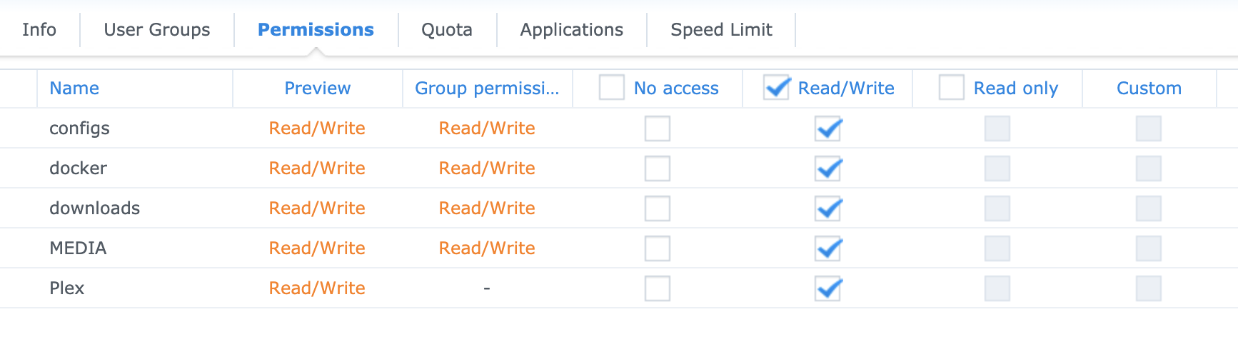

And my permissions in Sonarr look like this…
I’ve opened up user permissions to the following:
Still same issue remains.

those are permissions for the root of each shared folder, you need to confirm subfolder ownership/access as well.
in DSM start File Station, find one of the paths youre using, right click on it and and select properties
make sure the user matching the PUID is the owner, and that the group matching the PGID has full control permissions (and that it applies to subfolders)
go all the way down to a problematic path and make sure the permissions have ended up being set properly
