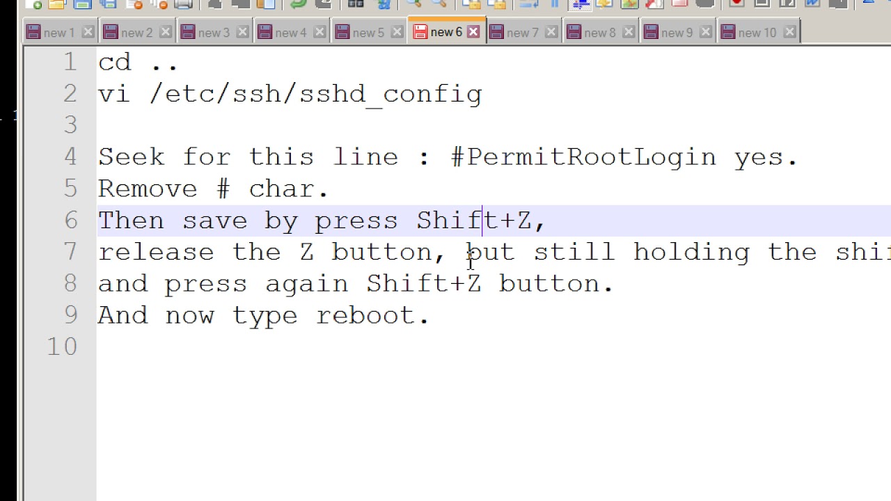

I found this, which basically walked me through;
After this, with FTP through winSCP i was able to replace the “service-setup” and redirect it to Mono Beta. In additional I changed the filename of “Mono beta”.

Good to hear you have it sorted. I see in the video it tells you to allow root login without sudo. Don’t forget to disable this again. It is a big security risk to leave it enabled.
