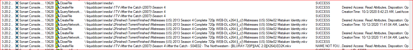

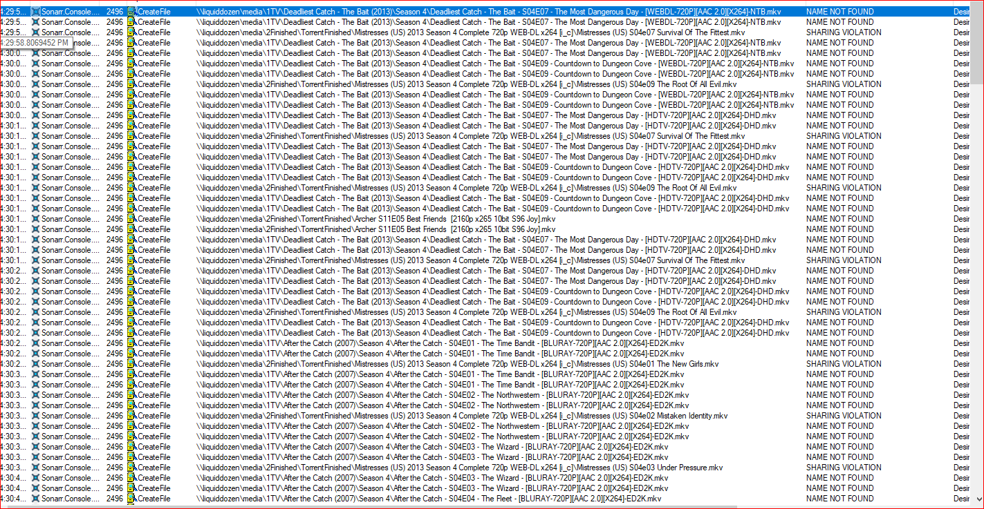

Here is Sonarr accessing the share just fine using procmon, a tool written by mark Russinovich who is the CTO of Microsoft.
Check out this error message ‘name not found’

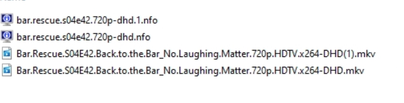

In the destination directory, THE FILE ALREADY EXISTS!
completely explains the ‘permissions error’ and it had NOTHING to do with the FROM side but the destination.
Due to previous failures, of course, there will be transactions half-completed. If sonarr crashes, the computer is turned off, power loss, etc. You must add code to gracefully handle these issues that ideally shouldn’t happen, OR we still have another oversight to fix still.
So the lesson learned is just because a log file says permission error, doesn’t always mean it is an access issue and it is the user’s fault. You WILL get a permission error if you try to create a file that already exists, even with full permissions.
this is the problem with log files and with this whole thread.
Why is there a file existing with 0 bytes? We need to figure that out next…

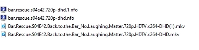

After watching this for a couple hours, what I saw was Sonarr faithfully moving (I have hard linking enabled, but due to my screwy circumstances) and the download client saw files were missing and without much thinking, my first reaction was to tell it to recheck and redownload what is missing.
So, what happened is the download completed, but during turning off/turning on the Sonarr service, and the errors of late: A season downloaded. I can’t say what triggered this situation, but it was in a state where the download client downloaded the whole thing, perhaps the hard lin failed at some point, and sonarr start moving the season, or was mid-move and stopped. So my download client restarts, saw that some parts of the files were missing (they were moved, partially?) and it threw a consistency error and showed to me the file was now no longer 100% downloaded. so I ran a re-check and it started downloading the “missing” episodes that I suspect were already moved by sonarr. in other words, since the client MOVED the file to the ‘I am finished directory’ sonarr did what it is supposed to, but a special case meant the client was downloading to the finished directory, hence the logs.
There is NO way to upload multiple days logs at this point to trace back HOW this happened, but I can tell you I have SEEN this situation crop up in the past, but it is rare.
I stopped sonarr so that my client will finish downloading. I deleted it manually from the client and I tried to manually import it, but it imported just fine. All I can figure is there is some timing problem where the client finished the download, but things started moving before the download client was told to remove the file from its queue. you would have to think like the process was mid-stream and ended to get this scenario. if you want to, I can totally agree this is an exception to the rule and move along. here is just the latest log: https://paste.drhack.net/?e74ab228ed11282f#521v1DytHhUqTA2p2ZJpW2ZTmHqP7tawquygnJTGsxjT

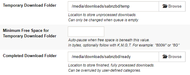

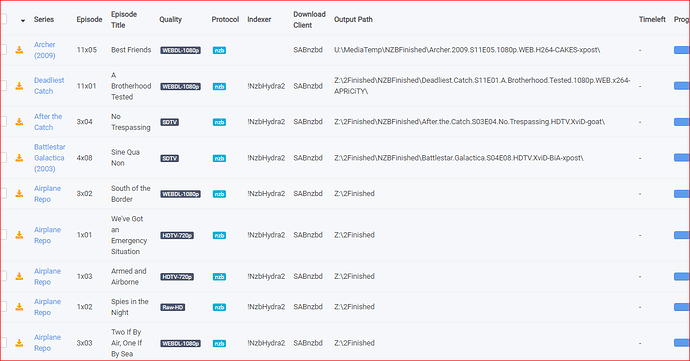

I have a TON of files showing up in the activity log that do NOT map to anything I can see in either client. I have never understood how this is supposed to work/display.
Sonarr shows:
SAB:

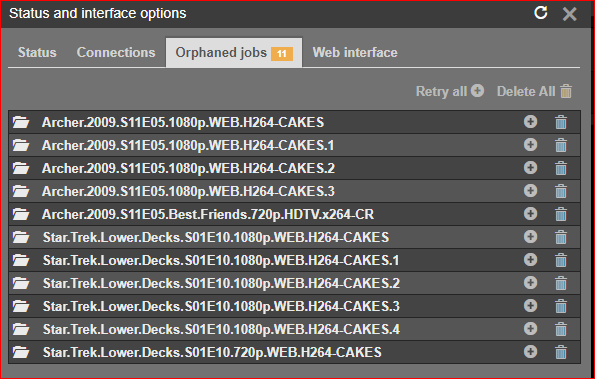

huh, turned on tabbed view, and now I see orphaned jobs.
SAB Orphaned:
I deleted the orphaned jobs from SAB as I confirmed they already exist in my Plex final directory.
But Sonarr still shows all the same jobs in some queue or pending.
Here is my torrent client

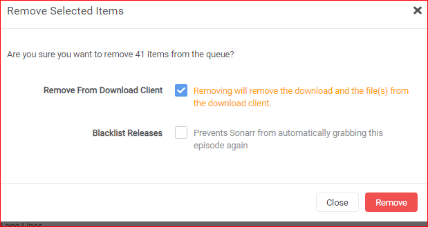

So something in sonarr is holding onto these shows, and perhaps is why as you can see multiple attempts to download the same show in SAB.
I will remove these in Sonarr and hope that finally cleans everything out.

out of curiosity are you letting sonarr delete the completed and failed jobs?
most of them appear to just be in z:\2finished which im pretty sure isnt where they would end up being download to? as its the “root” folder for your downloads.
ie sab would have put it under the category folder (tv, unless you didnt set a path?), same with qbit (tv-sonarr - i think)
manually importing those files would have also broken the pending manual intervention jobs, thered be no way for those to ever complete and youd have to cancel them in either sonarr or the download client to clean them up.

I’m new to news, but struggled through it. There seems v to be a bug with sab, it was saving to root, moving it down one folder level changed it to create individual folders per. When I moved everything local, I put torrents and news in seperate sub folders for a visual way to diagnose future issues. I’ve not seen way to create tv folder at the client.

The screen shots above show the state of all clients and sonarr. There were tons of items you can see above that I can’t find in any client. Where else can I look? Wait you said history? That had to be it,but why would it list anything competed?
Yes sonarr manages the deletions.

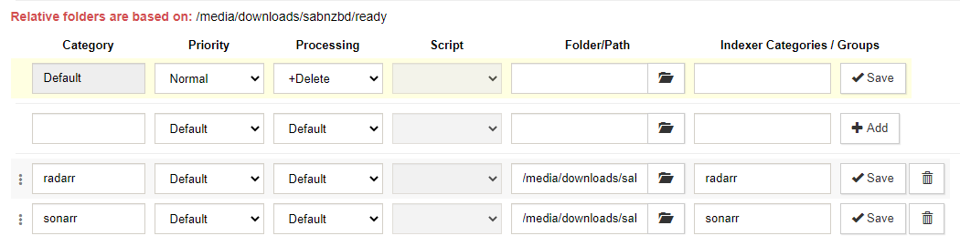

in the config, under folders, set the download and completed paths. these are where your jobs, outside of sonarr, will go
save those and change to the categories tab
here youll see the completed path is where things will go unless you set them otherwise. you could, if you want, just use subfolders underneath the completed folder, so just sonarr and radarr fo the path, but i wanted to make sure they were completely separated from each other so i used a (fully specified) path on the same level
so all my sonarr jobs end up in /media/downloads/sabnzbd/sonarr and my radarr jobs end up in /media/downloads/sabnzbd/radarr
remember this page will only let you update one entry at a time, so dont make changes to more than one before saving it.

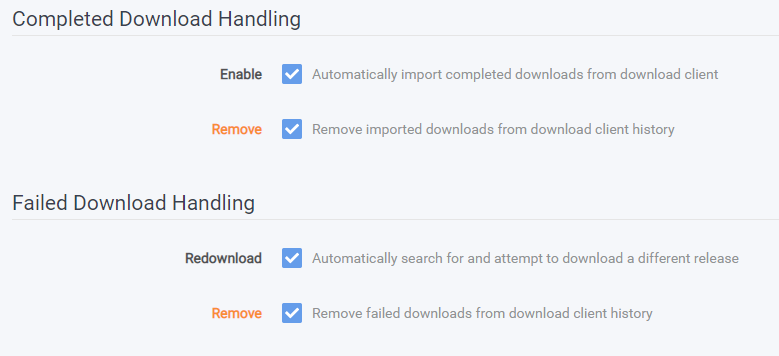

because sonarr asks the download client for a list of jobs that were assigned the “sonarr” category you set, and includes history because the job is still there. yes its completed, so history, from sabs point of view, but sonarr only processes jobs once they are completed (ie history).
which tends to be why you also let sonarr remove jobs from the history, its easier for cleanup.
youre not letting sonarr handle failed download cleanups, which is fine, but obviously will leave failures in place for you to figure out what went wrong, and for you to manually clean up as well.
those jobs will likely remain in the sonarr activity (with orange “i need help” icons) until you do clean them up (in either sonarr or the download client).

if I had found them in the log, then I would be okay with them showing on the client. The timing insists it had to be reset within the last hour.
you have ignore duplicates enabled in sab so it will delete any job that it sees as a duplicate, and just like manually deleting a job in the download client, it will just disappear from sonarrs activity queue without anything in the sonarr log about it (although there might be something in the trace level logs but im not sure)
20-10-14 16:56:11.4|Info|DownloadService|Report sent to SABnzbd. Bar.Rescue.S04E43.Geting.Freaki.at.the.Tiki.720p.SPIK.WEBRip.AAC2.0.H.264-NTb
im fairly certain sonarr doesnt keep a list of active jobs itself, its just querying the download clients for what they have and displaying those

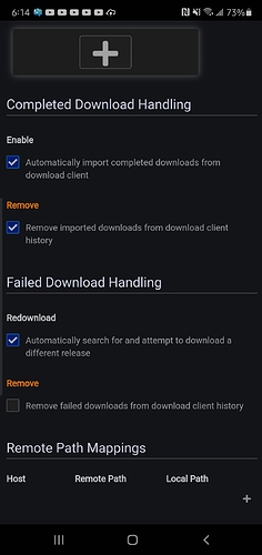

i would let sonarr remove failed jobs, that will stop them from building up in the future
i would just delete all of those in sonarr, its obviously from a time when you were testing a different path so just get rid of them.
unless thats your new path? in which case you need to work out why theyre failing to import.
if they are legitiamte failures then allowing sonarr to remove those jobs would be cleaner (and cause you less stress)

Here is what is in the directory for s04e42
I don’t see anything that should trigger a problem, but v no idea why there are two copies of the show, unless it is related to the multiple download requests.
It shouldn’t be this freaking hard.
Yeah I wish it was that easy. I wouldn’t be here asking for help if it was. It was matching the wrong season, then starting there was files that met the need, but it was looking at the wrong season… So moot.
Question:based on a previous statement, if the storage used by DL clients is local, no remote mapping is needed, correct?
this may be a bad example to use
well for starters thats not s04e42. Back to the Bar: No Laughing Matter is s00e09, one of the specials
http://thexem.de/xem/show/4605 shows that show is a mess. im not sure exactly how to read that but it does sort of look like s04e45 maps to s05e12 via xem
there also two copies of the file in there, so its going to have import issues anyway (unless one is small and possibly a sample file).

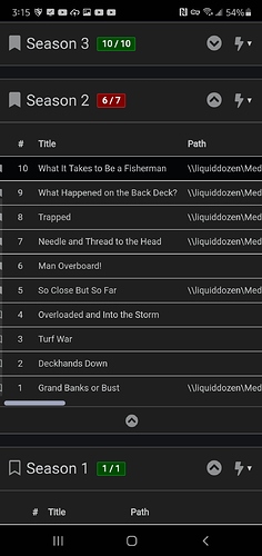

Found another bug. . Img registering as a video file?
See the line with a file named. Img? Yeah that one. It shouldn’t register as a file, not sure how this got copied in, but that happened some time ago.
