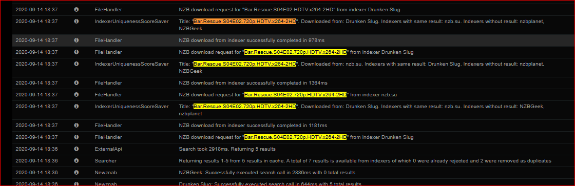

nbzHYDRA2 is dropping this because it is set to NOT allow duplicate downloads, so it fails the download, Sonarr then marks Hydra as bad and stops using it.
20-9-14 18:37:05.1|Debug|Sabnzbd|Downloaded nzb for episode ‘Bar.Rescue.S04E02.720p.HDTV.x264-2HD’ finished (329541 bytes from http://localhost:5076/getnzb/api/4767315701809300865?apikey=(removed)
20-9-14 18:37:05.1|Info|Sabnzbd|Adding report [Bar.Rescue.S04E02.720p.HDTV.x264-2HD] to the queue.
20-9-14 18:37:05.1|Debug|SabnzbdProxy|Url: http://192.168.1.162:18080/api?mode=addfile&cat=tv&priority=-100&apikey=(removed)&output=json
20-9-14 18:37:05.6|Warn|ProcessDownloadDecisions|Couldn’t add report to download queue. Bar.Rescue.S04E02.720p.HDTV.x264-2HD
[v3.0.3.924] NzbDrone.Core.Exceptions.DownloadClientRejectedReleaseException: SABnzbd rejected the NZB for an unknown reason
at NzbDrone.Core.Download.Clients.Sabnzbd.Sabnzbd.AddFromNzbFile(RemoteEpisode remoteEpisode, String filename, Byte[] fileContent) in M:\BuildAgent\work\63739567f01dbcc2\src\NzbDrone.Core\Download\Clients\Sabnzbd\Sabnzbd.cs:line 46
at NzbDrone.Core.Download.UsenetClientBase1.Download(RemoteEpisode remoteEpisode) in M:\BuildAgent\work\63739567f01dbcc2\src\NzbDrone.Core\Download\UsenetClientBase.cs:line 79 at NzbDrone.Core.Download.DownloadService.DownloadReport(RemoteEpisode remoteEpisode) in M:\BuildAgent\work\63739567f01dbcc2\src\NzbDrone.Core\Download\DownloadService.cs:line 95 at NzbDrone.Core.Download.ProcessDownloadDecisions.ProcessDecisions(List1 decisions) in M:\BuildAgent\work\63739567f01dbcc2\src\NzbDrone.Core\Download\ProcessDownloadDecisions.cs:line 77
20-9-14 18:37:05.7|Debug|IndexerFactory|Temporarily ignoring indexer !NzbHydra2 till 9/14/2020 6:42:05 PM due to recent failures.
