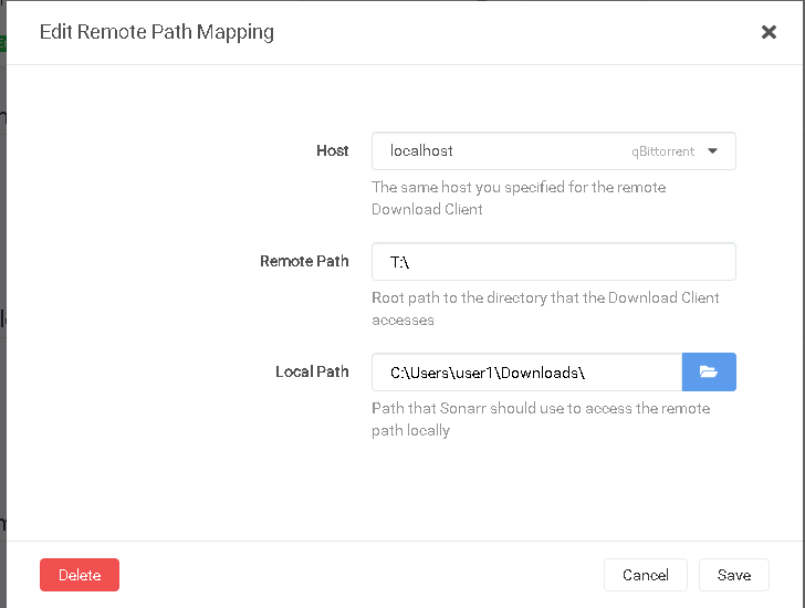

It appears so, so you’ll need to setup a remote path mapping to remap the remote path (from the download client) to the local path (the one Sonarr can access, which would be on C:\ and T:\ respectively.

Ok, so I have removed the root path(T:) and added the path where all the series are stored and sorted(D:). As per the screenshot you can see that Qbit’s download path is (T:). The importing continues to fail.

Delete that Remote Path Mapping, right now all it does is tell Sonarr to look in the wrong place for downloads. Unless there is a reason you’re doing that?
Yes there is, the reason I’m doing that is because sonarr requires it, reference the screenshot. Unless you meant to delete the “entire mapping” and not just the “remote path”.

Ok, so I went ahead and deleted the entire “Edit Remote Path Mapping”.

Yes, I mean delete the entire mapping and why I said “Delete that Remote Path Mapping” not “Delete the Remote Path from the mapping” (or something similar).
In this case sure, because you’re telling Sonarr to import files from a place that doesn’t have those files with that Remote Path Mapping.

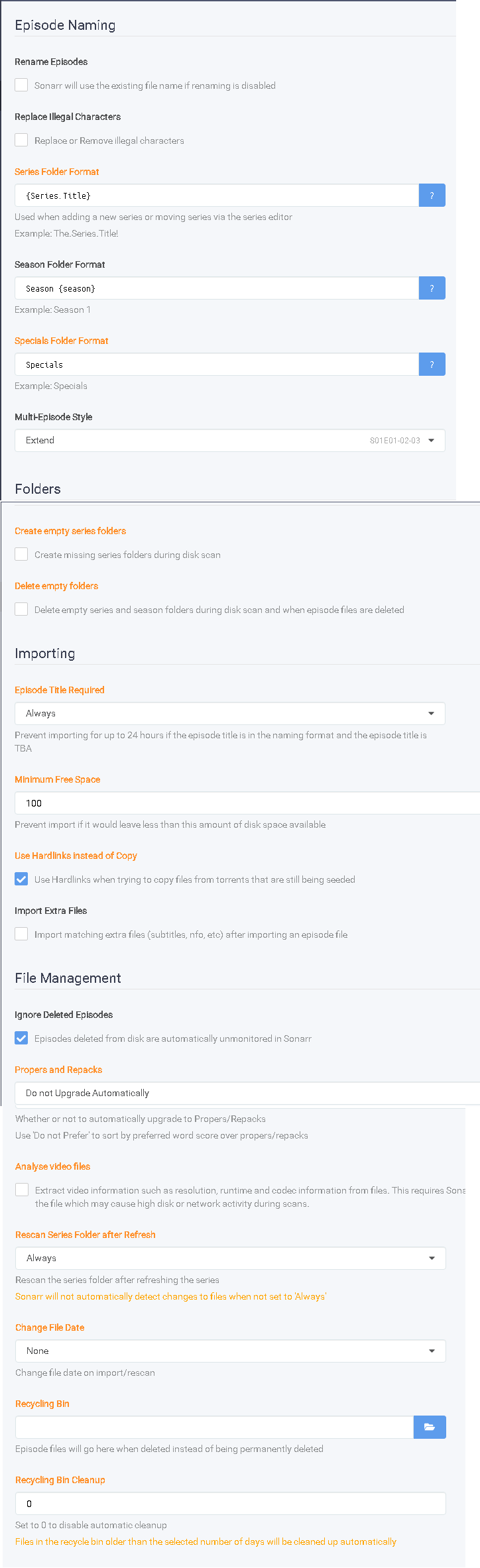

Yes, that is what I meant, however, I do not have sonarr renaming any files nor to create any missing folders> in the media management category the only items that i have checked are ‘Use Hardlinks instead of Copy’ and ‘Ignore Deleted Episodes’.

The only rename setting that I modified was for the series title to place periods between words of the titlename, everything else I left default. What do you suggest I set the episode name to? The names are fine as they are except the appended [rarbg] at the end of each file; for example: episodetitle.S02E17.720p.WEB.H264-AMRAP[rarbg].mkv

Those aren’t episode names. If those are the files there then Sonarr did not rename them. Which matches your settings because you’ve told Sonarr not to rename files. The change you made only affects the series folders.

Those files are not tagged with the [rarbg] at the end of the file names, sonarr does that to the files after it renames the folder since those folders are tagged with [rarbg] from the indexer. If these files were sent directly from the indexer to the torrent client, then only the folder names would have [rarbg] appended at the end of the folders only. So my question is what file rename option can I set in sonarr to prevent the file name from including that at the end of the file name?
