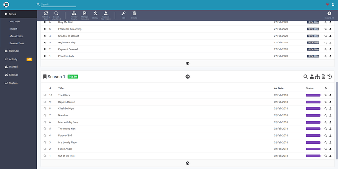

Yes, and one more thing - if I download incomplete season pack (even with one first episode) Sonarr shows all files in season with “downloading, 100% complete” status

It says “Download wasn’t grabbed by Sonarr and not in a category, Skipping.” Actually I have a few hundreds of skipped shows.

Ok, so logic for v3 can be described as:
- if the episode or season pack is added by Sonarr - it ignores
"isFinished":falseand imports it just fine (quality is shown in Status field) - if the episode or season pack is not added by Sonarr - it “skips” it in queue and show In Progress state (which is strange, if it is skipped) “Downloading 100%”. This is valid for all 619 skipped series.
