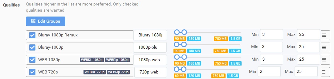

Your Sonarr looks different than mine, are you using version 3?
Probably your 1a or 1b is what I was thinking of. If for example we could make multiple WEB 1080p quality definitions, one each for 1GB, 2GB, 3GB, etc, and then we could rank those definitions when we make a profile. To me thats the easiest way to do it.
