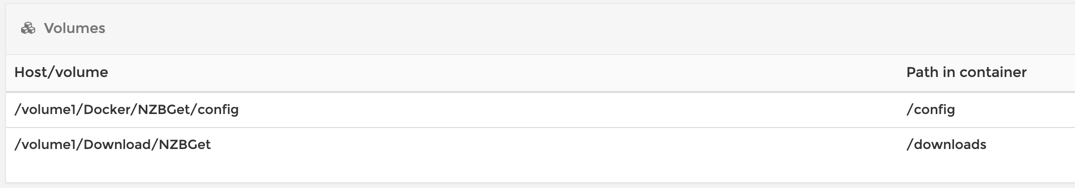

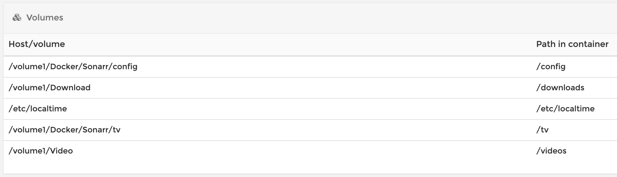

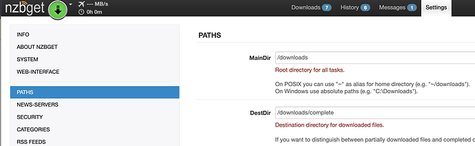

The PUID and PGID for both the Sonarr and NZBGet containers inside Docker are set to: 999
The Sonarr PUID and PGID was set automatically during the upgrade from non-docker to dockerized version of the app installed from Asustor’s App Central.
With IL2BT’s help I set the NZBGet PUID and PGID to match Sonarr’s.

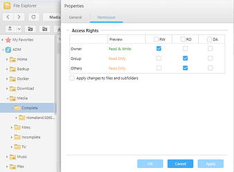

Access control for both containers and volume1/Download is set to administrators.

note - the ownership there might be for docker, not the underlying volumes. you need to note down all the host paths mapped into each container and ensure that (for example) user 1000 is the owner (so has full control), and group 1000 also has full control (including to subfolders), so for asustor youd use the adm file explorer, or SSH in and use *nix commands
