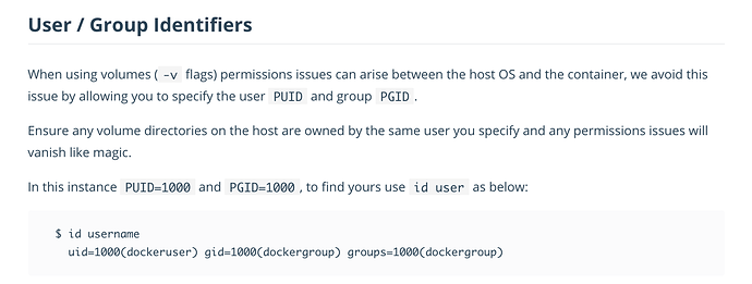

You need to tell docker containers which user they have to “simulate” inside the container (PUID/PGID variables) for access as well. Easiest is to use the same user for all your containers, which has access to all folders it needs. Or different users in the same group, you get the idea.

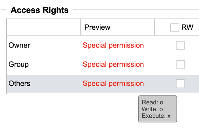

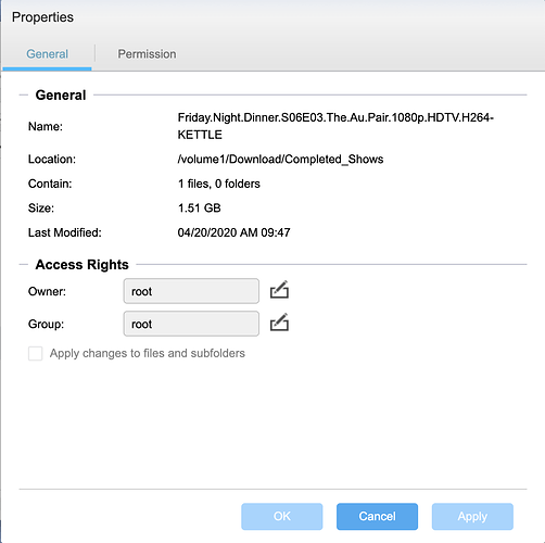

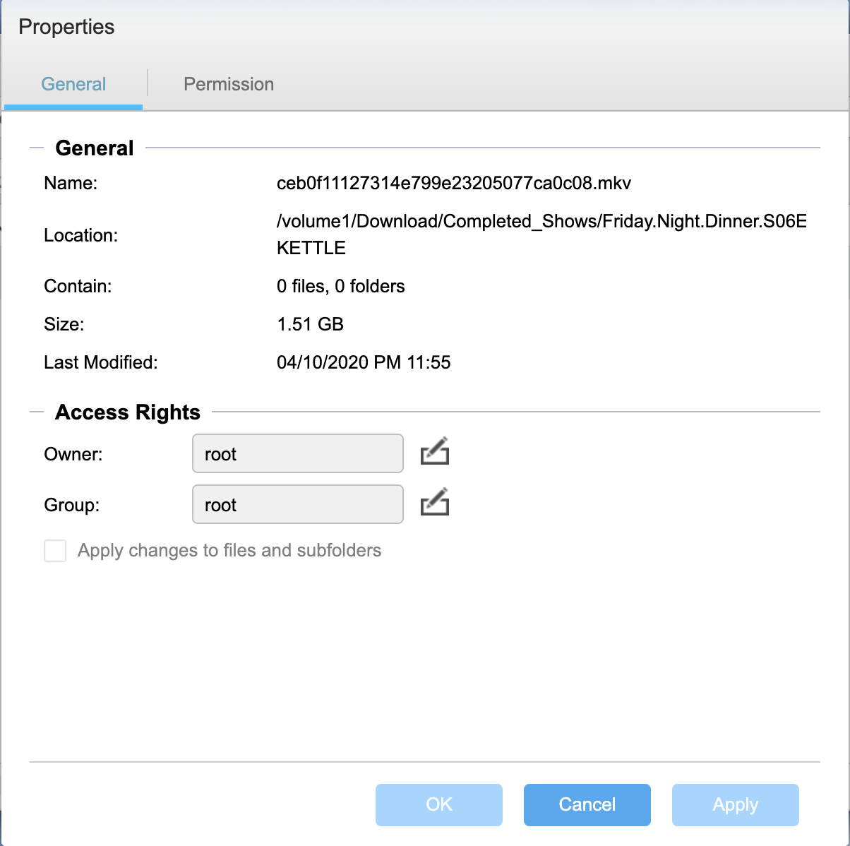

My attention has turned to NZBGet, and the permissions it sets on downloads. I now believe that Sonarr isn’t able to move and rename because the file permissions set by NZBGet prevent it.

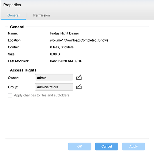

When I get Permissions in ADM’s file manager on folders inside:
volume1/Downloads/Completed_Shows/
*Including new series folders created by Sonarr
I notice that the Owner and Group permissions are:
Back to NZBGet > Settings > Security. Based on the info I found here: https://forum.nzbget.net/viewtopic.php?t=3140 I made sure the DaemonUsername = admin. Then changed the UMask = 0000
Then NZBGet > Settings > Unpack. Set UnrarCmd = unrar x -ai to ignore file attributes (permissions) that might be kept for the downloaded file.
No joy.
I think I need some way of changing the file ownership applied by NZBGet on new downloads to:

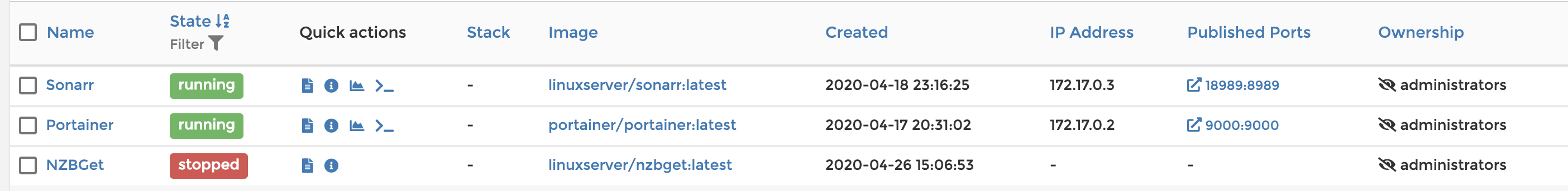

open Portainer and click on Containers, and then Add Container
now we’re basically going to translate what is under Usage into Portainer, anything I skip over leave as default
Name: NZBGet (or whatever you like really)
Image: linuxserver/nzbget (you can also use certain tags if you want to use dev builds, or an older version, but not adding one will just use the latest release build, the same as using linuxserver/nzbget:latest)
Manual network port publishing: click publish a new network port host: 6789 (or anything that isn’t already used, you’ve already noticed that Asustor adds a 1 to the start of the port number to avoid any conflicts. Whatever port you specify may need to be forwarded on your router and in ADM > Settings > Manual Connect > EZ-Router > Self define - e.g. NZBGet, TCP, 6789, 6789, 6789) container: 6789
Volumes: click map additional volumes container: /config (then click Bind) host: /volume1/Docker/NZBGet/config (or wherever you want, this is just the template Asustor would use)
Click map additional volumes again container: /downloads (then click Bind) host: /volume1/Download (or wherever you want)

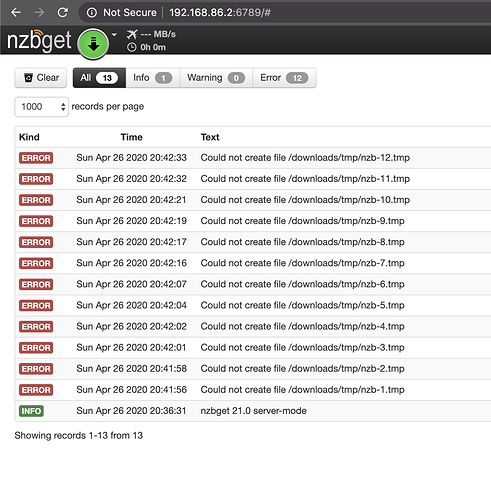

Env: click add environment variable name: PUID value: 999 (or whatever is being used by Sonarr)
Click add environment variable again name: PGID value: 999 (or whatever is being used by Sonarr)
Click add environment variable again name: TZ value: Europe/London (or whatever is being used by Sonarr)
Restart policy:Unless stopped
Then click Deploy the container!
Hopefully it will be just that simple for you. Either way, let me know

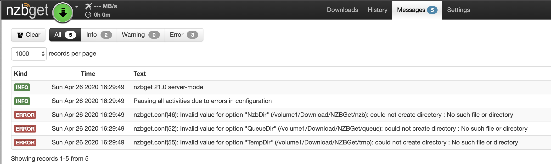

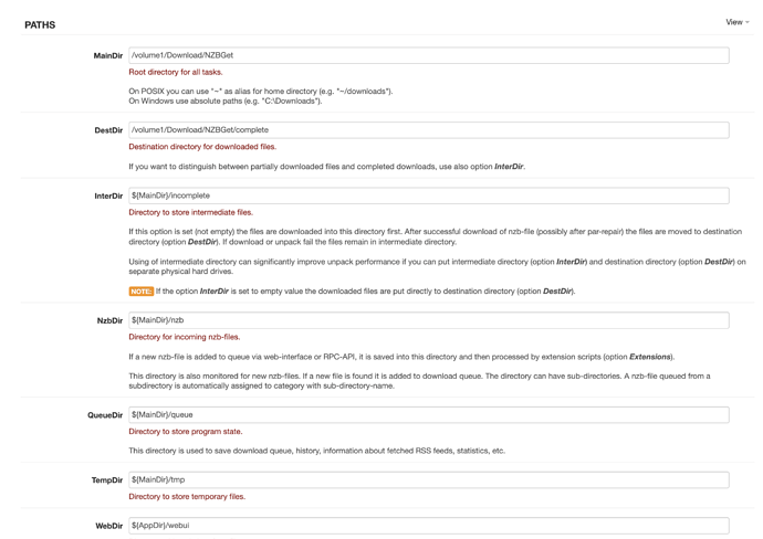

Change MainDir to /downloads and DestDir to /downloads/complete or seemingly ${MainDir}/complete would work too (might need to use \ instead of /, but I assume not).
Basically the path you have set for container is what NZBGet will see, and then Docker will translate that to the path you have set for host.
See if that fixes the restart issue, if not then try:
Portainer > Containers > NZBGet > Container details > Restart policies > Always > Update

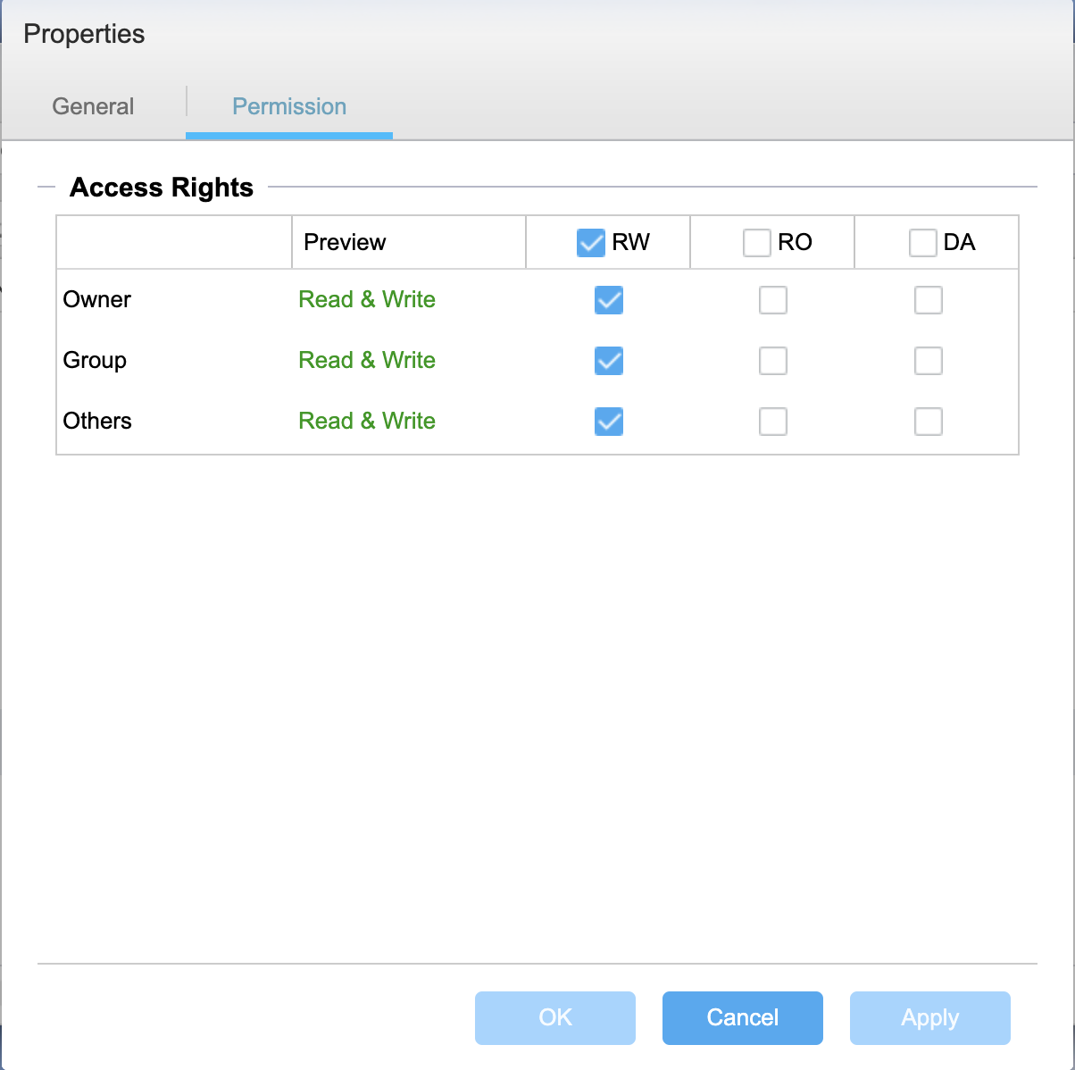

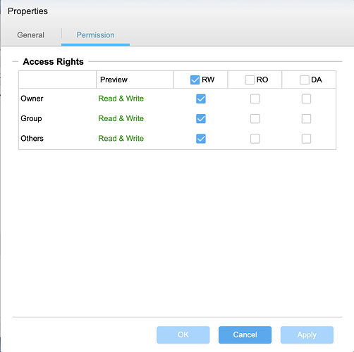

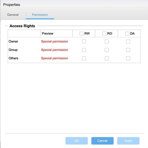

The weird thing is if I manually set the permissions to be consistent with the containing folders and force NZBGet to reprocess I get the same error in Sonarr’s logs.
I’ve played around with Sonarr > Settings > Media Management > Permissions > OFF / ON with permissions set as 0777 folders and 0666 FIies.
And set the NZBGet > Settings > Unpack > UnrarCmd > ${AppDir}/unrar x -ai
(This should ignore file attributes (permissions) of the downloaded file).
Just haven’t found the magical combination it seems.
Sonarr sends the request for the episode or season pack to NZBGet
NZBGet downloads into .../NZBGet/incomplete
once the download finishes it moves the files to .../NZBGet/complete

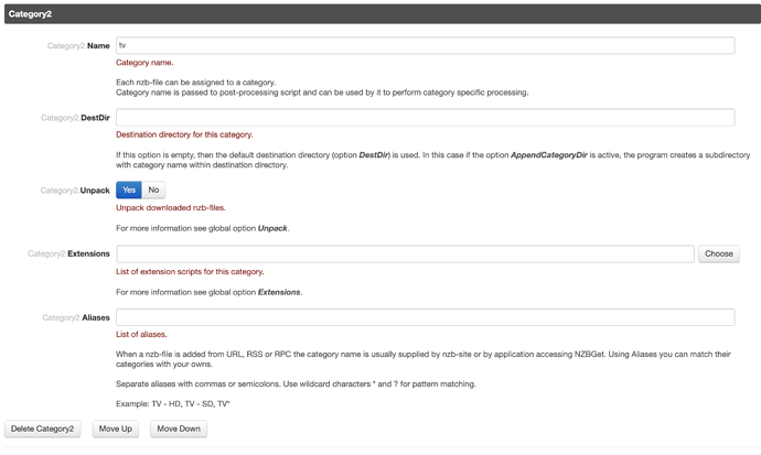

In Sonarr > Settings > Download Client > NZBGet > Catagory = tv
I do this because I only use Sonarr for tv shows. Looking at NZBGet’s categories I notice the setting for ‘DestDir’. If left blank it creates the ‘tv’ directory, so that’s working correctly.
Not sure if that’s correct or not. But the permissions on:
volume1/Download/NZBGet/complete/tv/Breeders.S01E06.1080p.AMZN.WEB-DL/Breeders.S01E06.1080p.AMZN.WEB-DL.DD+5.1.H.264-iKA.mkv are:
