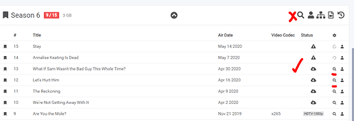

A big part of why i think there is a sonarr issue is if i click the small “magnifer” glass next to an episode, it will work correctly (ie it gets sent to qbittorrent), but if i click the Larger “magnifer” glass (ie mag. glass next to a season or entire show), then only a few eps get sent over to qbittorrent. The same goes for the “Wanted” section, if i choose “Search ALL” some get sent over to qbit, but not all that should be. Now in the wanted section if i just choose a single page, select ALL on that page, and choose “Search Selected”, generally all that should be sent over ARE (but why when i click “Search ALL (wanted)” did it not send them over? ).

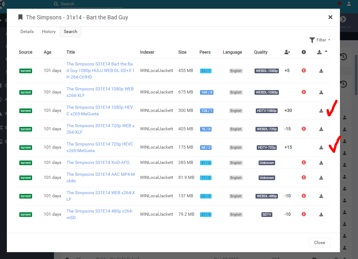

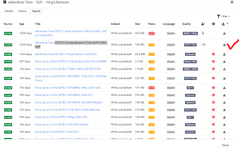

EPs being found (check marks should be sent to qbittorrent, right? in this case the 1080p one should be sent over)
If i click the mag. glass with the red X next to it, it will send a few eps over to qbittorrent but NOT all from this season. BUT if i click the small mag glass next to a single episode (with the red check) it will always send torrent over to qbittorrent (assuming ofcourse there is a valid, filtered, torrent sonarr likes).

Here is another example, i had clicked “Search Monitored” for the entire show, Adventure Time. The gui shows that “Adventure Time S07E21 A Kings Ransom 720p HDTV x264-W4F” should be sent to qbittorrent, the debug log shows that its “Release Accpeted” but it never gets sent to qbittorrent. And “release accpeted” is the entry for this torrent in the debug logs:
(note- several other Adventure Time episodes were sent over to qbittorernt in this specific “search monitored” run, but i dont understand why this particular episode, along with a few others, were not also sent over)

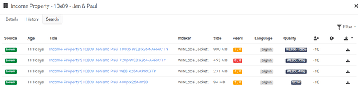

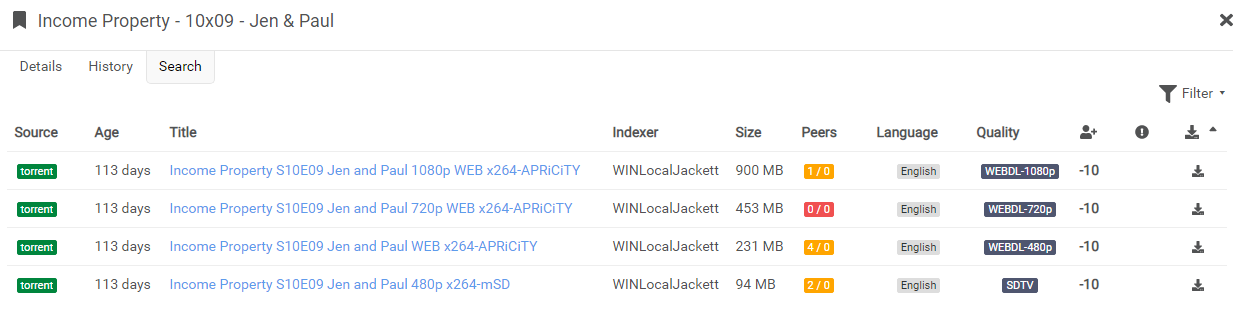

So this time i deleted all .log files, then ran a single season scan on a episode that does not get sent to qbit when i think it should be- (all 4x torrents for “Jen and Paul s10e09” show as “release accepted” in debug logs, but related log entries stop there.).
here is everything in the debug logs (1 .zip file , or lmk how you would like me to post or grep out this, its ~1mb uncompressed ):
https://gofile.io/d/Ou58MN
(or what i should be searching for. because what i see is in the logs is its scanning Season10 of this show, then 4x release accepcted, but then instread of giving a message about sending any of the 4x torrents to qbit, the debug log just moves on to a different, un-related show on my wanted list- so im not sure what i should be looking or search for next).

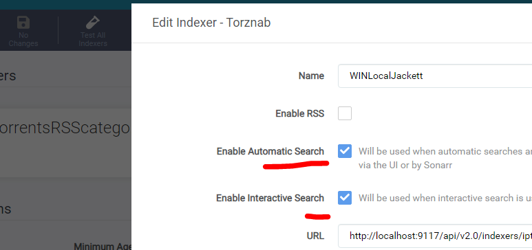

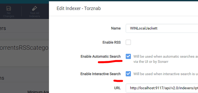

I do have the indexer that is finding these torrents properly setup (ie enable auto search, is enabled);
The season search starts around ‘20-6-15 11:49:43.4’ producing 50 releases.
I checked, none of those 50 include episode 9… ergo you’re indexer isn’t returning them.
search for DownloadDecisionMaker|Processing release you’ll get 54 results, 50 for the season search, and 4 for the episode search. None of the 50 is for episode 9.
Query the url yourself that’s shown at the top. That’s what sonarr uses to query the indexer.
It’s either a problem in Jackett or in iptorrents.
