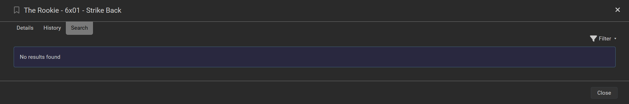

And still nothing found,but i know the episode exist on TL.
Sonarr’s log after search:
2024-05-02 10:43:48.8|Info|ReleaseSearchService|Searching indexers for [The Rookie : S06E01]. 2 active indexers
2024-05-02 10:44:07.0|Info|DownloadDecisionMaker|No results found

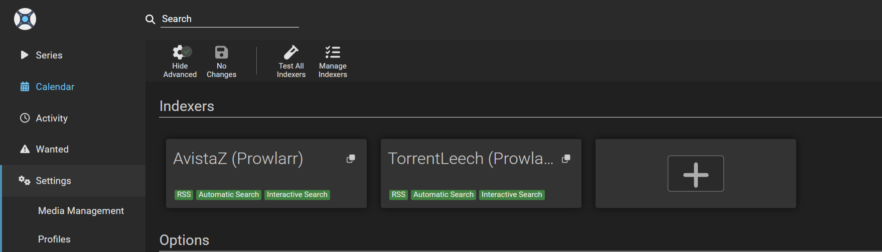

Edit: I just noticed that on AvistaZ Prowlarr use these parameters as well to search but not on TL.
Could this be the issue ? Using Sonarr on AvistaZ works fine for me does the job well.It worked with TL as well but recently stopped working for some tv shows.I changed nothing in settings.

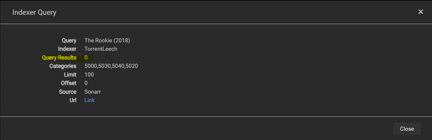

There are ten results on TorrentLeech for The Rookie S06E01. This drops to zero results if you enable searching freeleech only in the indexer’s settings, so check that.

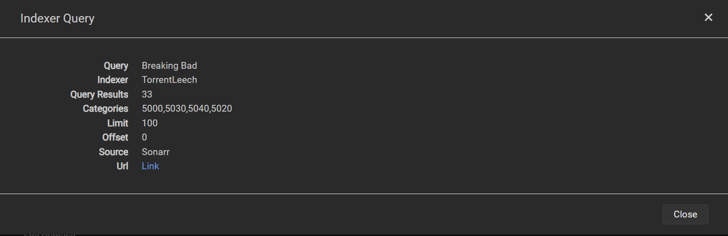

In Prowlarr’s history view, click the info button for the search, it will show you how many results were returned and the search URL that was used, so you can double-check if it’s showing zero results.

Prowlarr’s history view info button:
If I search something that’s on AvistaZ it works,it gives me results.
It says that TL indexer is on as well green checkmark.No error there.
For expamle if I searched using Sonarr’s interactive search Breaking Bad Season 5 it gave me results:

The only ‘non-scene’ releases for The Rookie on TL are for season 1 and 2. Is there a reason you’re excluding scene releases?
Sorry I thought SCENE releases meant the release group name
ex. Hate Thy Neighbor S02 1080p WEB x264-SCENE and they are usually using rar files and I don’t like them.
Now that I unchecked the Exclude SCENE torrents from results everyting works fine.
I was foolish sorry.Thank you for your help.Have a nice day !
