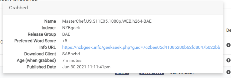

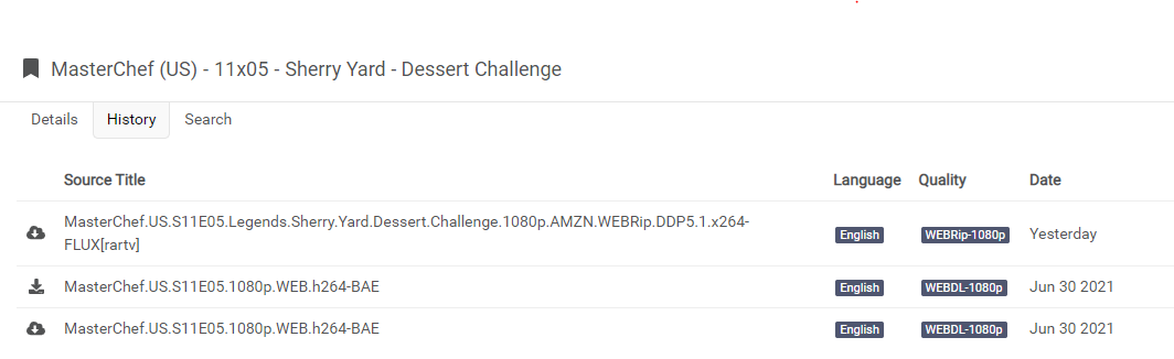

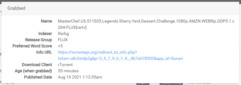

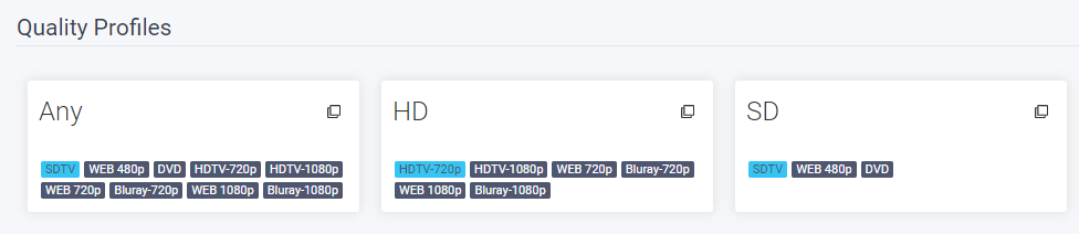

Sonarr just recently started “upgrading” videos which already meet the cut-off quality, and example if shown in the below image, and the bottom image shows my profiles and their “Upgrade Until” setting. So this example cut-off is set to HDTV-720p, the existing file was WebDL-1080p, and Sonarr downloaded a WebRip-1080p “upgrade” (even though this should not be an upgrade). I just enabled debug logs, so I don’t have the current ones captured with debug, but my logs are all uploaded, and I will add the debug logs when this happens again, as needed.

Web rip and web dl may be grouped together but order in the quality matters and a preferred word is always an upgrade, so it may technically be a quality updated as wel
Ok, but it is supposed to stop upgrading quality at HDTV-720p, and tit wasn’t a preferred word upgrade, it was the same. It hasn’t picked up anymore yet, so I doubt there would be anything usful in the newer logs.
EDIT: I do notice the old one has BAE in it, which is supposed to give it a -5, so that is probably why. I probably added that after the original file was downloaded, and that is why the score shows the same.
