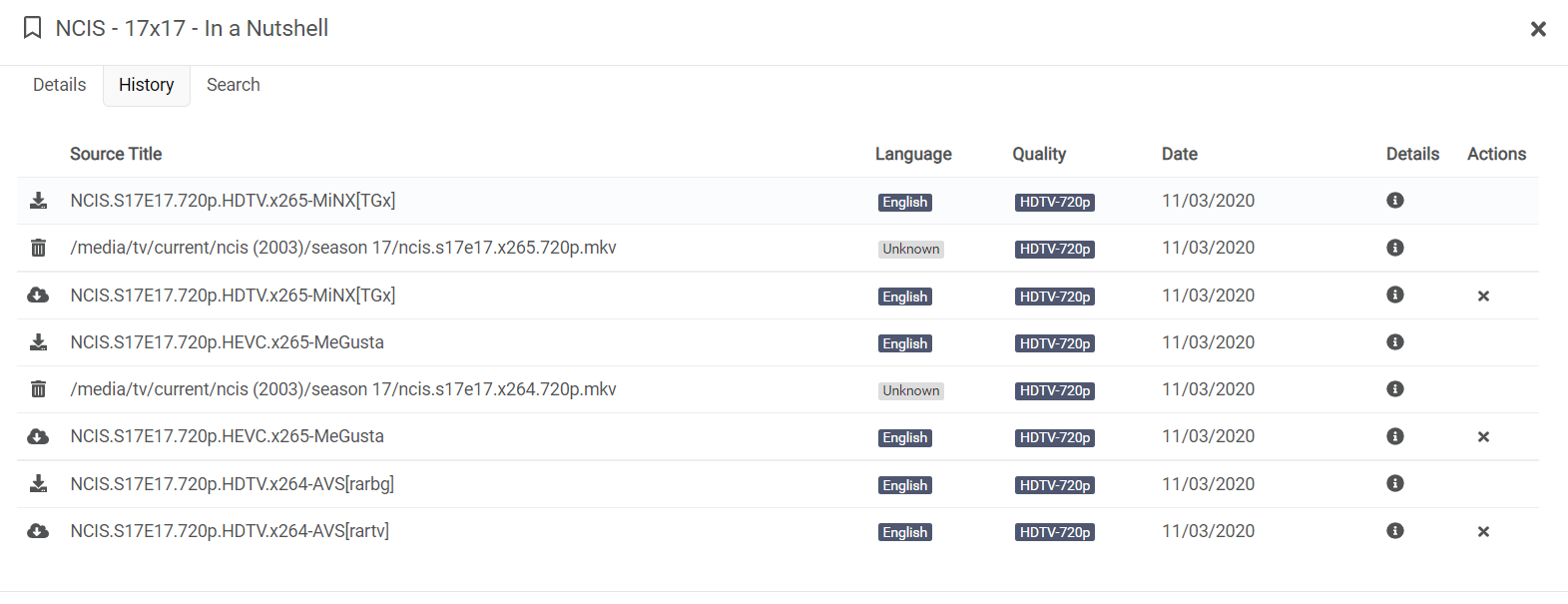

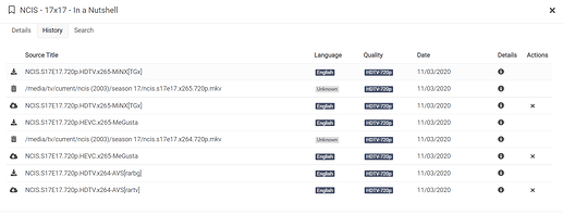

Screenshot would be the easiest way.
Here the history screenshots.
Just to clarify. I do monitor these shows, but not the seasons these episodes are in.
a screenshot of the actual episode history would probably be better as it will show the entire history of that episode. presumably at some point sonarr initially grabbed it but youre saying its doing it multiple times, so there should be multiple grabs in the episode history.
eg; open the series, open the season, click on the episodes title, click on the history tab
you can also mouse over the info icon of each entry to see its specifics
