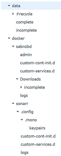

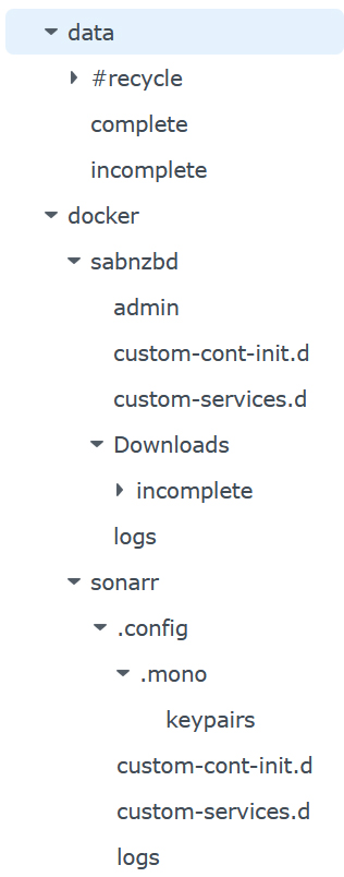

But now I have no Root Folder and cannot add any in in Media Management…
Any Idea?
Permissions and ownership - likely from following a poor guide
glad to see you didn’t even bother looking at the docker guide or trash’s guide.
Sorry Bakerboy, but I did and will again re permissions and ownership…
@bakerboy448
Thanks for pointing me to https://trash-guides.info/How-to-setup-for/Synology/
I deleted all the crap I had from other guides and started all over with a clean Docker and File Station.
It’s amazing how great it all works now!
This guide should be at the top of Google Search and I can recommend it to everybody who’s new to Docker.
