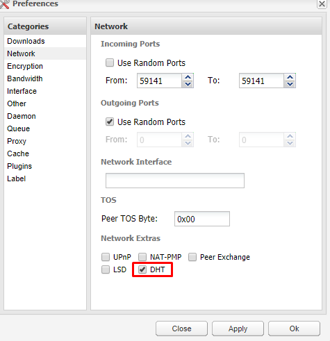

So, deluge. The DHT Nodes are at the bottom of the status bar on the right, it shows the number of connected nodes. It should be non-zero.
The associated settings are under Preferences->Network. which has ‘Network Extras’ at the bottom with DHT as a checkbox. Disregard the other settings, they’re likely different for you.
