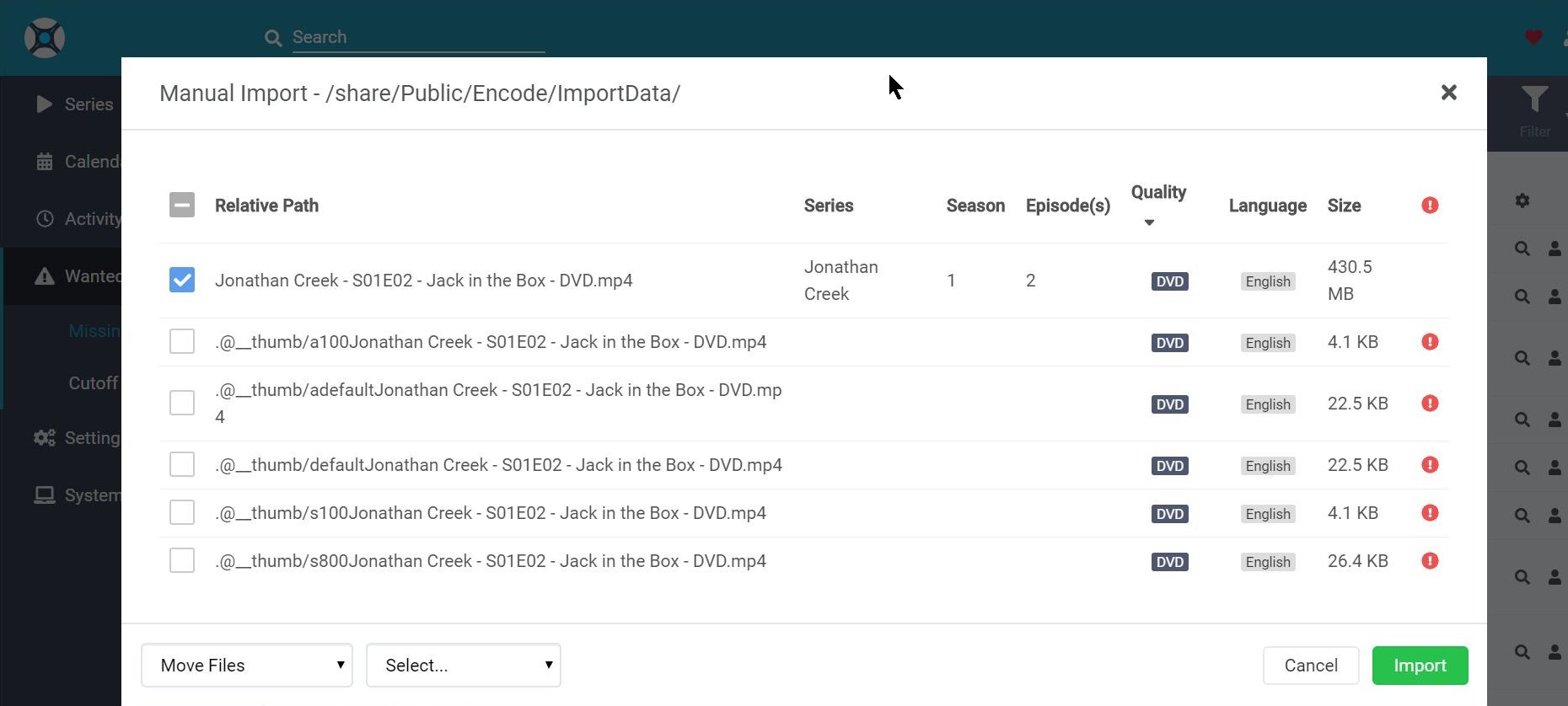

**Sonarr version 3.0.3.741:
**Mono version 5.20.1.19
OS: QNAP QTS 4.4.1
When I run a Manual import on a folder which contains an MP4 file and a thumbnail subfolder named .@_thumb which should be ignored as it starts with a period, I see all the items in the thumbnail folder presented in the list. (see screenshot)
With a large number of video files, the number of thumbnails create extra workload and extend the list unnecessarily.
Can these be suppressed please?
Sonarr does not ignore files/folders because of a period at the start, we don’t plan to either, but we should be able to filter out the files in the thumb folder, but need to know if that’s a double underscore or some other character that looks like it.

The Directory name has 2 underscores - and I have pasted it in hex - 2E405F5F7468756D62.

I don’t see any path with .@__, so I assume it’s a random debug log, which won’t show anything, but should be fine without.

https://github.com/Sonarr/Sonarr/commit/b5e734b9e511d8eda155b3256d87b9901d016291 :wink:
I applied the updates as per the screen shot, Updates page and ran a manual import which still shows the files under the thumbnail directories - Screen shot of output
Debug log is here
Thanks, looks like there is an edge case specific to manual import that I missed, we’ll get it in an upcoming build.

Just updated to Version 3.0.3.757, and no mention of .@__thumb entries during a manual import where I know that a .@__thumb directory exists.
A great result - Thank you
