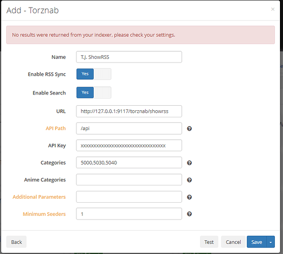

You probably have the wrong categories selected, notice the 5030,5040 in the url? Jackett is returning an empty result.
Here is my Jacket configuration:
I hadn’t added the 5000 Category in Sonarr, so I tried adding that as well. However, it still didn’t work (API key replaced with xxx…):
You should check the query url yourself, coz to me it seems like it’s a Jackett or indexer issue.
OK. Thanks, It appears to be an issue with Jackett (since Jackett Search works). I am waiting for a response from them
