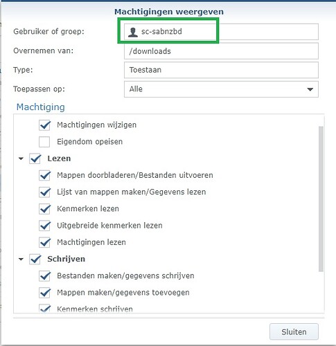

So I looked at the folder and permissions on my Synology DS418 and they were set to SC-Download for the mappings folder with all permissions exept take over ownership.
That is what I have set according the Sonarr manual I read online.
I have set the same permissions for the SC-NZBDrone.

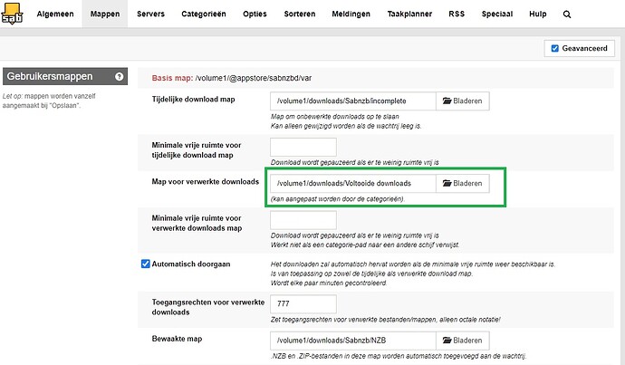

I renamed my mappings folder from Sickrage klaar voor Emby to Voltooide Downloads. Restarted the Sonarr service but now the Sonarr log keeps saying it looks in Sickrage klaar voor Emby.
I have used the same remote mapping folder as I have set in SABnzbd.
