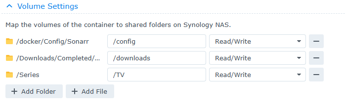

I have the below setup in the Docker:
Note the /Downloads/Completed folder is on Volume 1, and the /Series folder is on Volume 3.

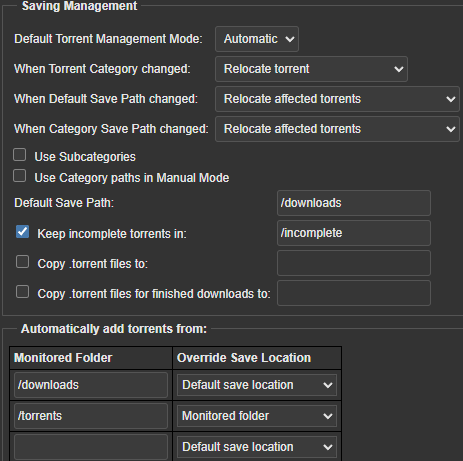

I’m using QBitTorrent as my client, again Docker image is the latest. Setup is below:

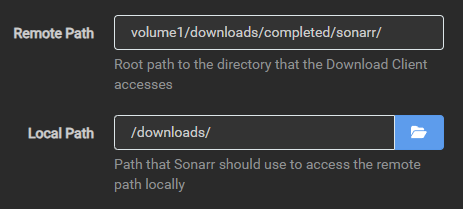

I have the below Remote path mapping in place in the WebUI for Sonarr:
The Local path is only /downloads/ as this seems to be the highest folder when I search, and there doesn’t exist any sub folders only the TV series that QBitTorrent has acquired.
