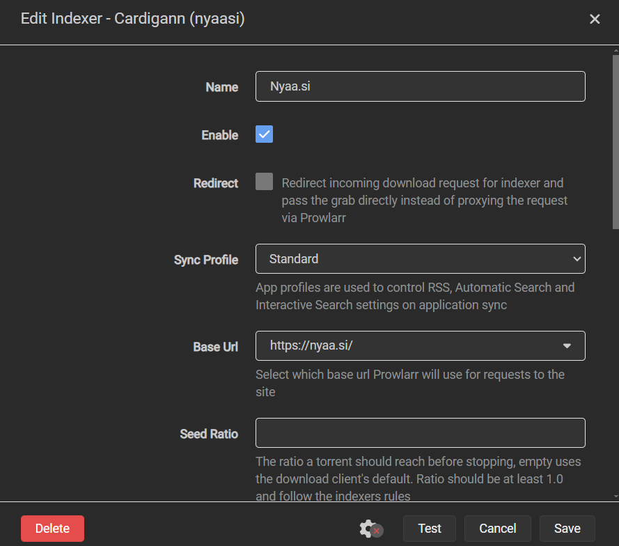

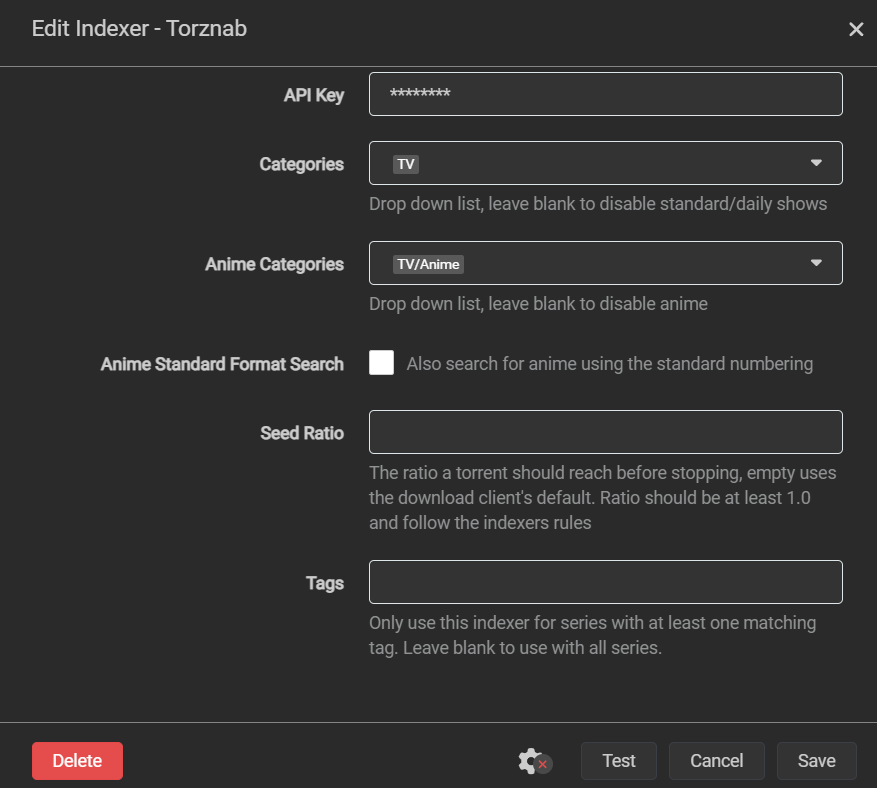

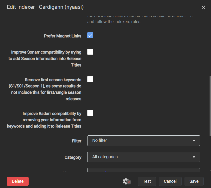

Provide screenshots of the indexer settings for Nyaa in Prowlarr and Sonarr, and provide debug Prowlarr and Sonarr logs for a manual search for a single episode of A Sign of Affection in Sonarr (just make sure there isn’t an RSS sync happening at the same time).
