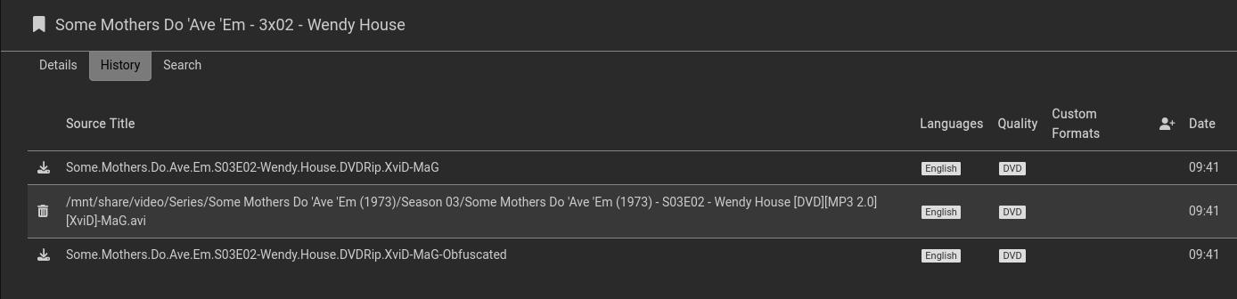

Hi, I am struggling for days now to get the custom format to download only the better quality till the set limit, but it keeps also downloading the lower versions.
With V3 of Sonarr it worked fine, but now with the update to V4, I am not getting anywhere with the settings?

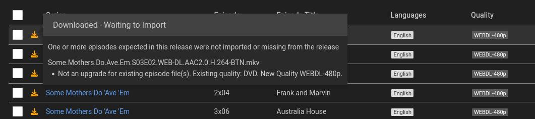

that doesnt look like a custom format issue, it seems normal.
the file you already have is 1080p (2nd quality), what was downloaded is 720p (6th quality), its not an upgrade according to your quality list so wont be imported by default.
not sure why sonarr would have grabbed it in the first place though, not unless the indexer job name has 1080p in it but the file inside it is actually 720p, or it was grabbed first and just took longer than the 1080p version to download?

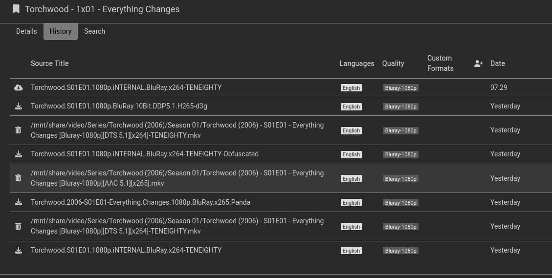

can you screenshot the episode history? that should show when it grabbed things, and why

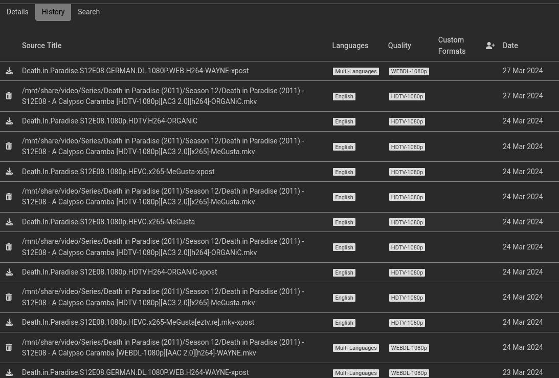

the upgrade until custom format score being set to 10000 is practically useless though as you only negatively score the ones you do have, the max is only ever going to be 0. you may as well put it back to 0 and set the upgrade until value to the max quality you want. ie is web-1080p or bluray-1080p where you really want to stop.
without checking debug logs it shouldnt have been able to drop from WEBDL-1080p to HDTV-1080p - or for that to then constantly “upgrade” to other HDTV-1080p variants as there are no custom format scores for any of them.
while youve shown how that “any” profile is setup, is that series actually set to use it?
theres also no grabs shown in the history so not sure how you are getting the files in the first place. is sonarr actually doing the grab or do you have something else in front of it?
if you have something else doing the grabs then its up that that system to work out if its an upgrade or not - sonarr would then import it if sonarr thinks it is an upgrade, but if it isnt youll get that warning you have now about it not actually being an upgrade.
theres no grab so that job must have still been active on your download client when you upgraded to v4 and would have to be a remnant from v3.
all of that history and database should have been converted from v3 to v4 unless you started from scratch and just imported the old root structure into a new one?
if you did that then the only way for v4 to see multiple files for the same episode is if there actually were multiple files for the same episode in those folders.
for each import entry (down arrow into a hard drive icon) in that history list mouse over the info icon on the right, that should tell you the source folder of the original file for that entry.
it still makes no sense, there are no grabs in the history and that list cant be filtered so they should be there if sonarr was grabbing them.

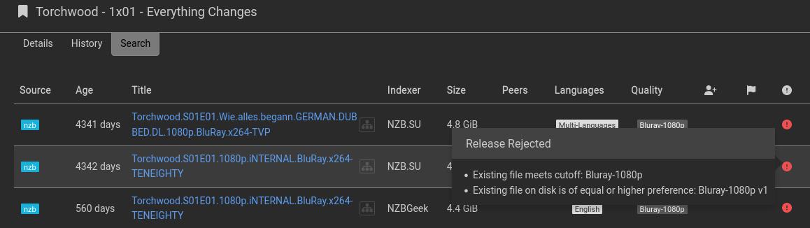

go back to that torchwood episode and its search tab, click on interactive search and manually grab any (nzb) download that is the same quality as the last one you have.
once grabbed close the search and then reopen the history, is the grab you just did listed or not?

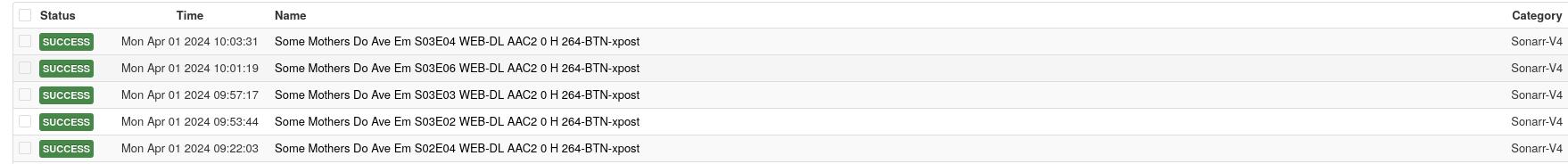

Hi Rhom,
I did your suggestion.
After a few days and grabbing a fresh test series. The only one that is DL in NZBGet is the sonarr-V4. I don’t see my old “series” category showing up…
