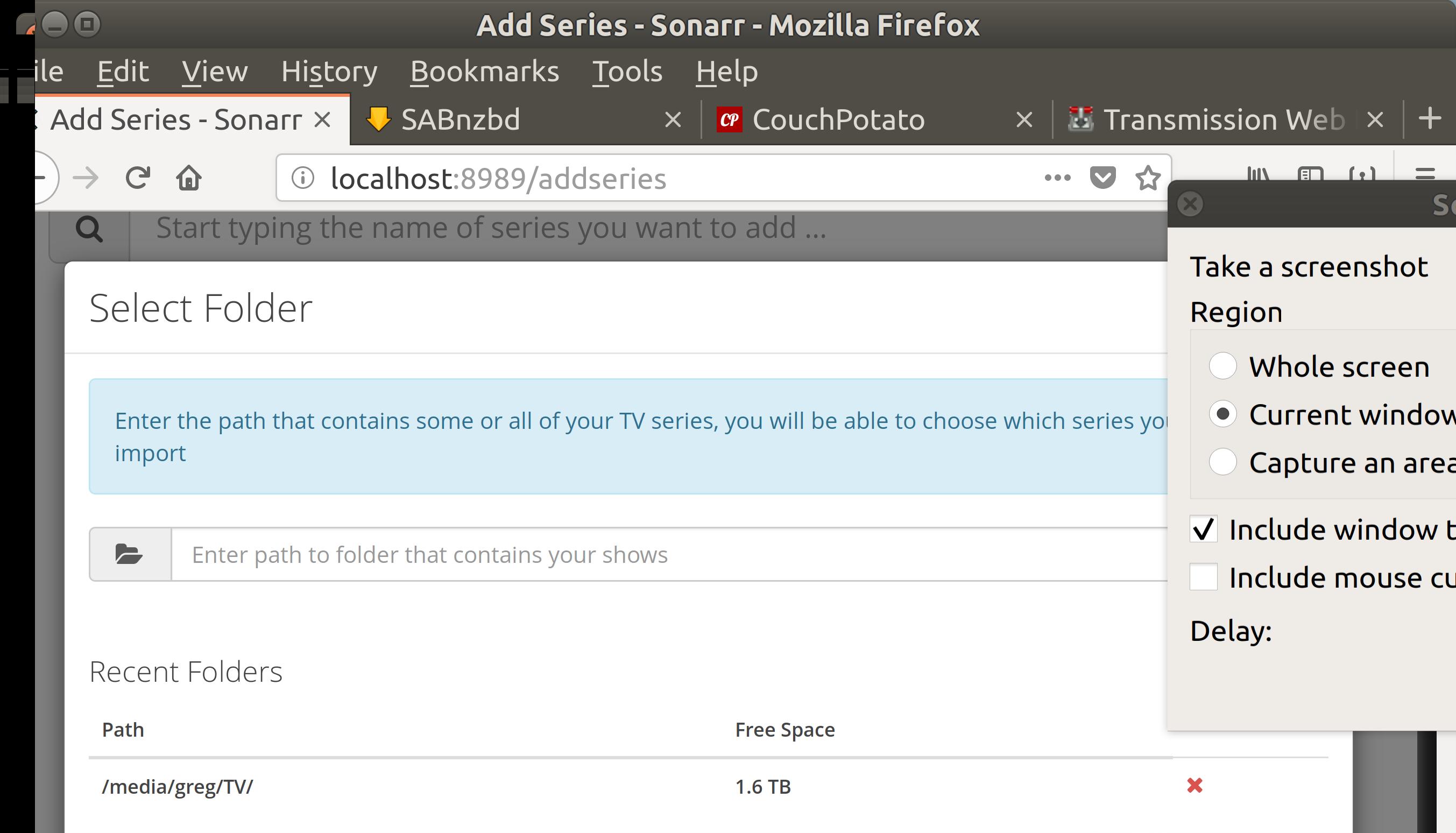

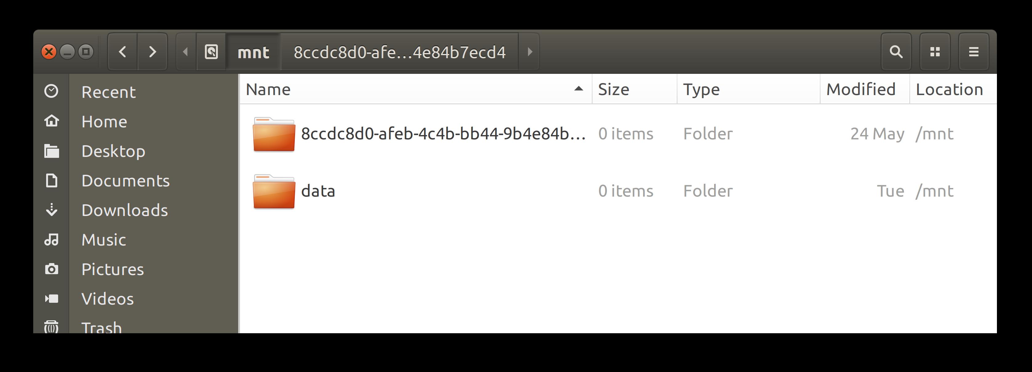

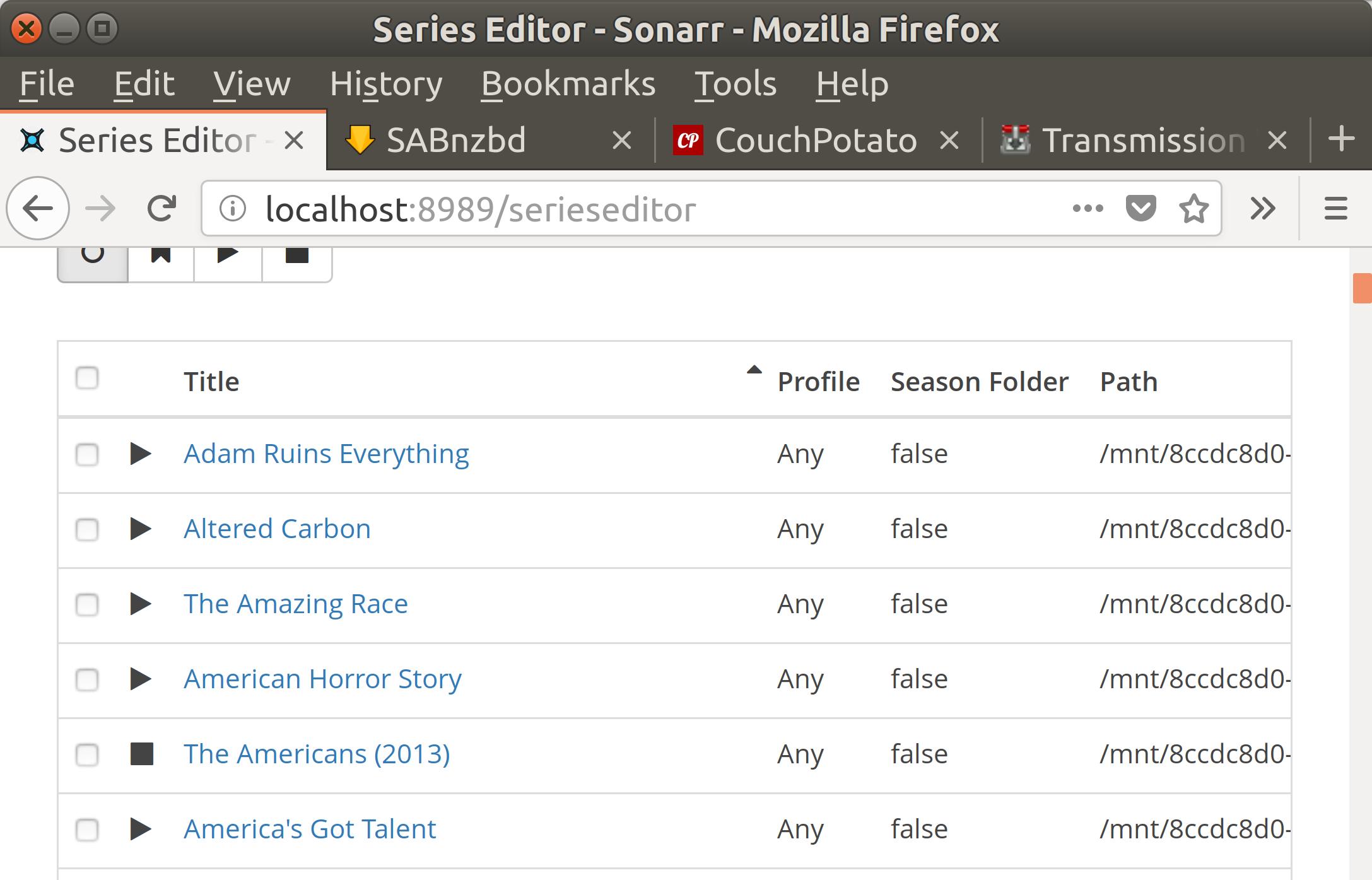

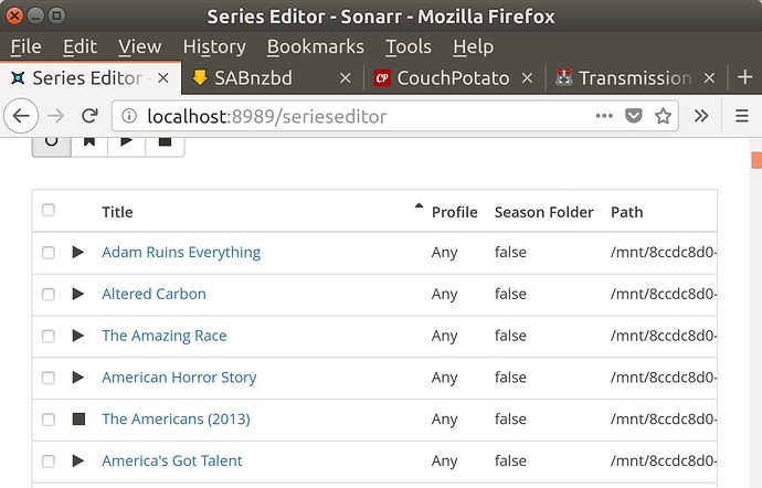

Here is my problem for the root folder. first picture shows empty mnt folder, second shows show edit base locations (impossible as its empty (but working)) the third shows current path.
so, the path currently being used is impossible as its empty
the path it thinks its using is not being used
I am getting confused
All your series are set to use /mnt/8ccd... based on the screenshot. Because they were set to use it before you removed the root folder. You need to update all the series paths in Sonarr to the new path.
thanks for the reply. I would have been happy to update the series paths but I couldn’t figure out a way to do that by bulk so it would mean changing every entry. I choose, instead, to rename the database file, change the root file, and re-import everything. I also had to reset all the settings. Given that I had been fighting everything this worked out for me and I spent a LOT less time doing this instead of trying to fix stuff.

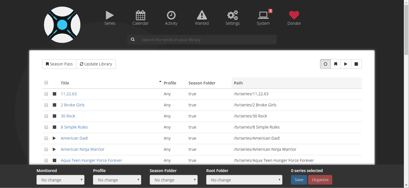

It’s right there in the Series Editor:
Select the series, change the root folder drop down and hit save.
