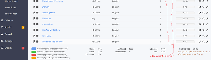

with sonarr running and you click series you get a nice list.
Series Title – Network–Tags–Quality Profile–Language Profile–Next Airing–Seasons–Episodes
the problem is i add shows month and years ahead of them showing. some times the Episodes always stay at 0/xxx because of a filter like language of the show is not in my settings or the size is greater that allowed etc.
Would it be hard to add another field that was a 1 or 0 answer so when we update shows and it sees some possible that it sets the flag to 1.
like this–
Series Title – Network–Tags–Quality Profile–Language Profile–Next Airing–Seasons–Episodes–Possible
this would help a lot looking thru the long list of series for new ones that may download with a settings change.

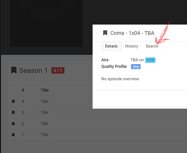

What I would like to achieve is a button to search every series with 0/xx currently found, for its first episode and or last episode. then flag that series as possible to download.

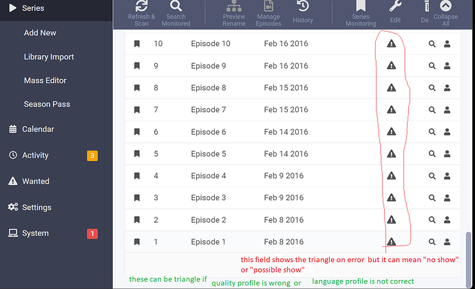

the reason for the flag is the series might not meat the profile requirement and never download an episode. Example the profile is set for 720 but show is sent in 1k or the show is sent in Korean but your language on the shows is set to English. this will leave the series at 0/xx with a triangle on the episodes.
what i do now is sort series by the network then i click the search on each this forces nzb lookup for every episode on every series. and when it is done i have no way to know if a show that is still 0/xx might be downloadable without opening every series and trying a manual download.
if there are some series
THEN if the language match and quality profile match and there is a nzb it should have downloaded
THEN if the language or quality does not match and there is a nzb it will set the Triangle on the series and not download ( this is where i like to add the possible flag to the series)
There’s nothing to set for the triangle. Triangle means the episode is missing.
No flags on the series are needed, you can filter to series missing episodes
