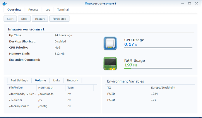

My settings on the Docker container look like this.
You’ll need to use a remote path mapping in Sonarr to remap the remote path (/volume1/downloads/Tv-Serier/) reported by your download client to a local path (/downloads) the conatiner can access.
have you set the PUID and PGID environment variables for the container to match the account you want that container to run as (and have its permissions)?
with what marcus said above, you want to ensure that the path your download clients use matches what you have mapped in sonarr. eg if transmission is saving to /downloads/transmission/complete then sonarr needs to see that path as well, in which case you mount /downloads to /downloads so the path is consistent across docker and the nas
your first container volume mapping is from /downloads/tv-serier to /downloads, as a quick check try mapping /downloads to /downloads instead and see if it finds the files. if it doesnt then what path have you got sickrage set to save completed files to?
sickrage tells sonarr the job is ready and where there file(s) are located (which will be a NAS path), eg /downloads/TV-Serier/completed.
Sonarr will then try to access that path (in the container) but it wont exist as the /downloads volume in the container was mapped a level down than the NAS. as a NAS path its trying to find /downloads/TV-Serier/TV-Serier/completed which doesnt exist so it fails. its why you tend to leave /downloads mapped to /downloads.
btw, the read/write flags in the mapping just tell the container what type it is. the PUID/PGID you set point to an actual user account on the NAS that has has been given the appropriate level of access to those locations.
