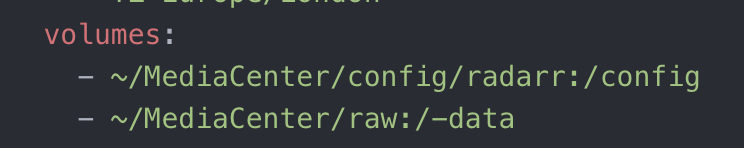

the volume mapping for ~MediaCenter/raw:/-data should just be ~MediaCenter/raw:/data, i have no idea what purpose the - in front of data is for (if its some mac specific thing then leave it but it seems odd)
that remote path mapping is probably pointless and you shouldnt need one if you setup the containers properly

the volume mapping for ~MediaCenter/raw:/-data should just be ~MediaCenter/raw:/data , i have no idea what purpose the - in front of data is for (if its some mac specific thing then leave it but it seems odd)
Naming from ldexterldesign ~ not sure why he was using dashes so just kept them. Does help separate out the default from the custom. Don’t think that - is the cause of rejected imports. Dash was only introduced from his posts, and the import problem existed before the dash.

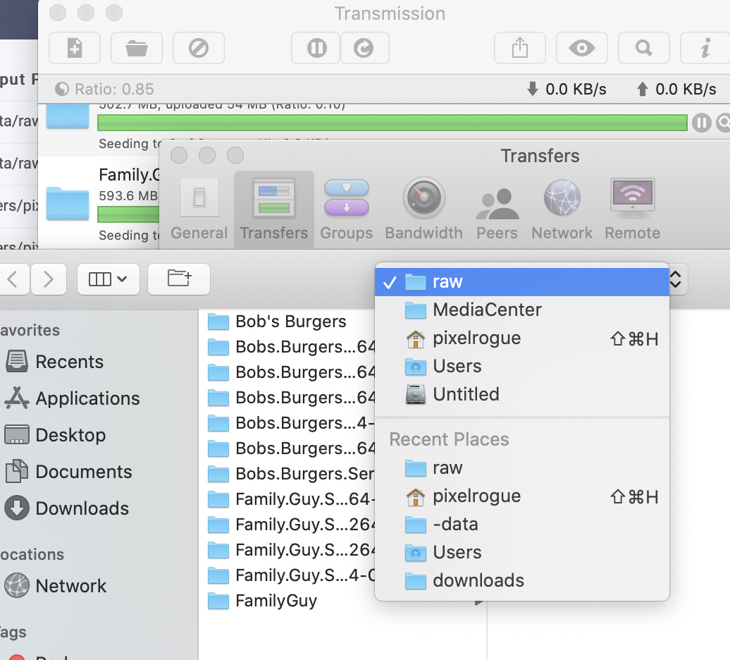

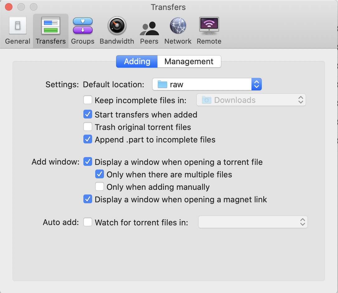

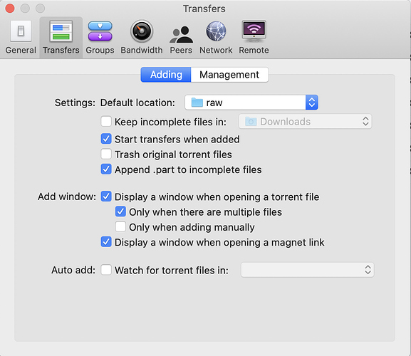

TRANSMISSION
Download folder is /Uses/pixelrogue/MediaCenter/raw
Complete = raw
Incomplete = not specified (traditionally the same spot as downloads, so raw in this case)

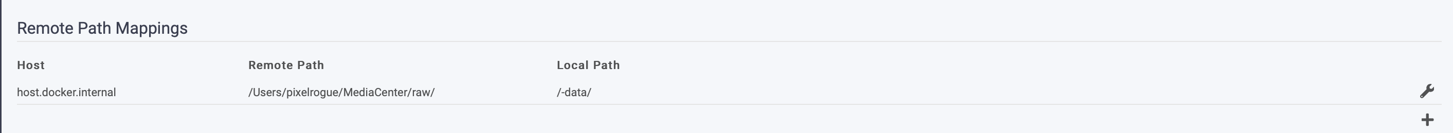

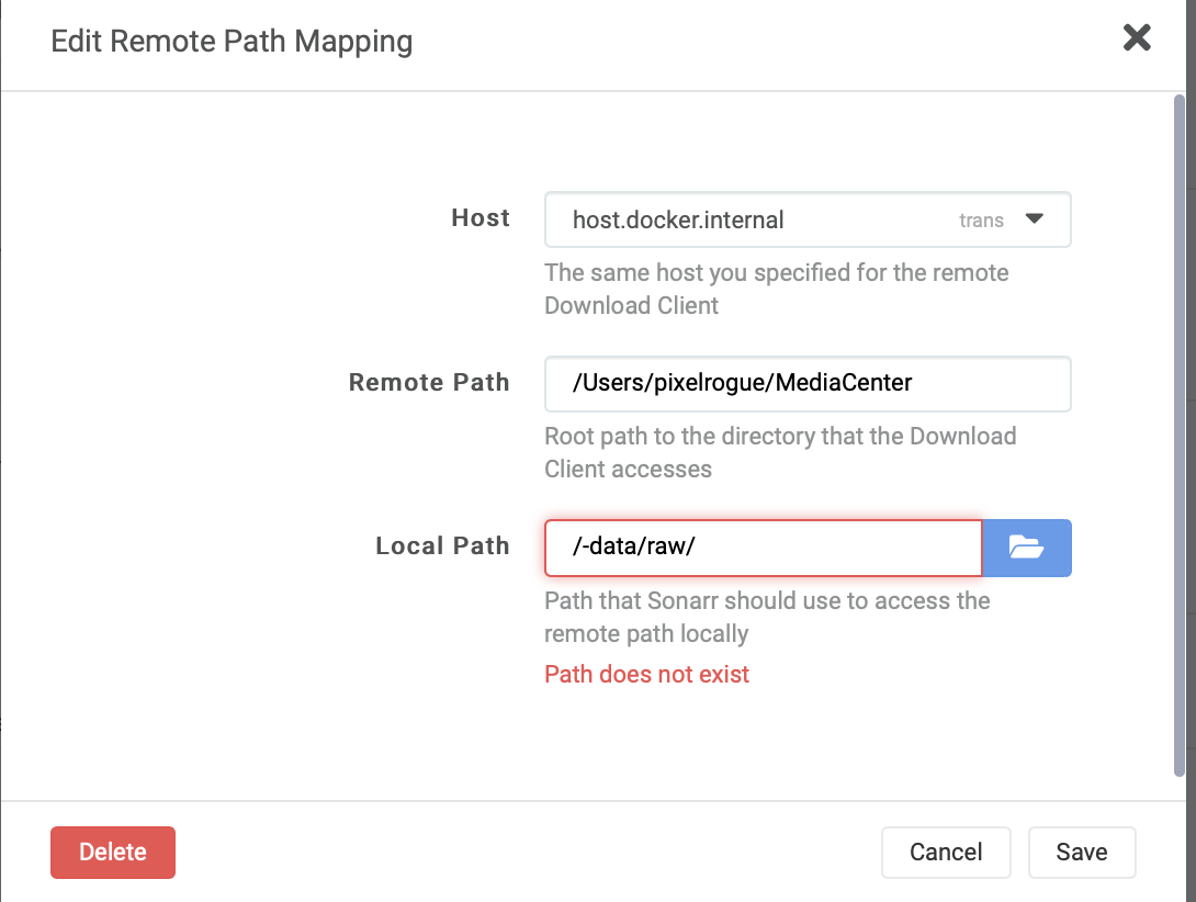

No, it’s definitely necessary, transmission is on the host, not another docker container. /Users/pixelrogue is not mounted in the container (no should it be).
It sounds like the remote path mapping is almost working, no sense trying to perfect things, let’s get it working first.
If you look at the path in the latest error there is an extra raw in there, either the volume mapping in docker is pointed to the parent of raw (in which case adding raw/ to the remote path mapping should fix it, or the transmission path has an extra raw.

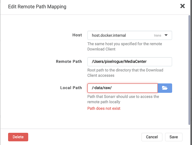

If you change the local path in the remote path mapping to make it /-data/raw/ does it work?
Not following the bit about the extra /raw?
Error is just showing the one raw, right?

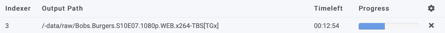

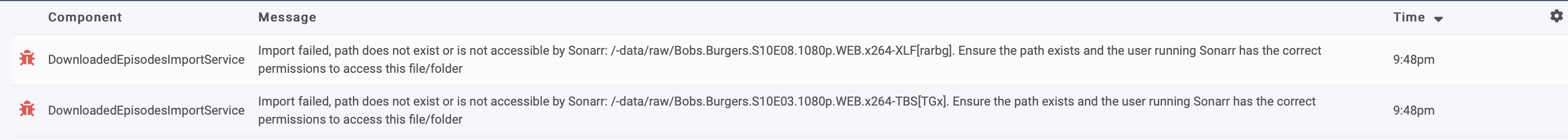

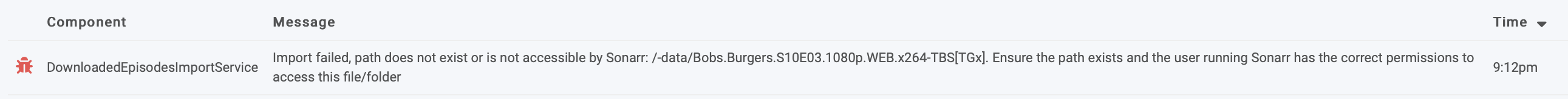

Import failed, path does not exist or is not accessible by Sonarr: /-data/raw/Bobs.Burgers.S10E08.1080p.WEB.x264-XLF[rarbg]. Ensure the path exists and the user running Sonarr has the correct permissions to access this file/folder
This is fresh, 10:10pm
Removing raw/ from the remote path will have the same effect, but if /-data/raw isn’t visible to Sonarr it’s almost certainly a permissions issue (and a good reason not to use your home directory for these apps, especially with docker.
Your screenshot before my previous replt of the remote path mapping showed a /raw at the end of the remote path, but now your most recent one doesn’t, but also your docker mappings showed a /raw on the host side, if it’s mapped to ../rawon the host then account for that in the remote ath mapping’s remote path.

Ok, so saying the URL is combination from those two locations.
On the Sonarr side, I have no options. /-raw is it (short of deleting everything, editing the compose file and rerunning it all again from scratch). Low level of confidence that will change anything. Can’t tell you how many times I’ve set up these docker containers is so many different ways. The most recent as a compose.yml has been the best of the bunch.
docker mappings show a /raw on the host side…
Which screen?
I am not seeing raw doubling up anywhere… not sure where to address this point.
I added an incomplete directory for those files. at the same time the priority is on getting rid of that error so the imports work properly. tweaks and everything can come later. wastes a lot of time on tweaks when someone wanting to help wants to start everything over again from the beginning - so I just let all that go until the error is fixed and reason is known.
Think the Transmission directory set up is now ok? Back to sonarr?

You posted recently and still had /raw on the end of the remote path if you changed that since I have no way of knowing, but it’s recent enough to assume you didn’t.

from a sonarr perspective it appears that transmission is putting completed files into /-data (or ~/MediaCenter/raw from the host) which is not something you want to do so were going to split them apart. never mix downloading and permanent content under the same folder.
change the volume mapping on the sonarr container from ~/MediaCenter/raw:/-data to ~/MediaCenter:/-data and delete/recreate the container

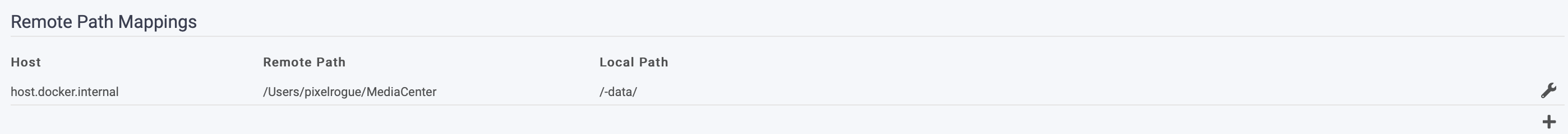

go to settings > download clients and down at the bottom edit the remote path mapping;
change the remote path to ~/MediaCenter/ and the local path to /-data/

Appreciate the patience, and the added detail of this post which is helping.
Currently at this step:
note - if import still does not work check the folder name it cannot see. if its the full expanded version of ~ (the home path) then you will need to edit the remote path mapping an set the remote path to /Users/pixelrogue/MediaCenter/ instead. (basically whatever is in the sonarr logs - and its case sensitive so copy/paste it from the log).
I have a directory for incomplete downloads open, one for complete downloads open and the sonarr directory open. Files have been successfully going from sonarr request > transmission > incomplete directory > complete directory.
