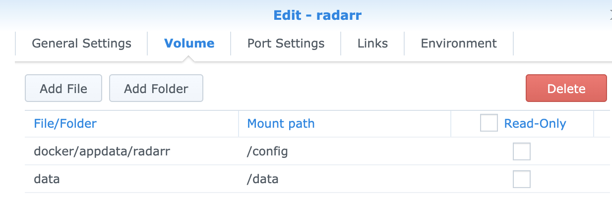

what is the actual folder structure on your nas? your first post says /media but now your saying /data
if you followed the trash guides then the only volume mapped in the containers should be /data = /data (or whatever your base path actually is) (plus your config but thats not important for this)
you would then reconfigure the dockered apps to use /data/.... based paths, not /tv or /downloads
eg;
transmission would be set to use /data/downloads/transmission/...
sabnzbd would be set to use /data/downloads/sabnzbd/...
sonarr would have a root path of /data/shows/...
radarr would have a root path of /data/movies/...
because your containers would all be using the same /data/... based paths they can then pass around those paths and they will all line up and be valid.
right now youve got what looks like random paths with no relation to each other, especially for transmission and sonarr - you can fix that with a remote path mapping in sonarr but its much simpler in the long term to fix it at the nas and container level so it will work across all your “media” containers.
