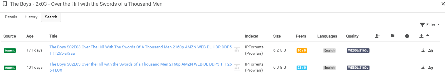

My second question, and the question that actually drove me to post this, is that when it was downloading individual episodes, it returned the first torrent on this list, even though the second torrent was the same quality and had more seeders. This should also be reflected in the first pass debug log. This is what the torrent selection looks like for this episode (S02E03):
Then, when I removed that specific episode from Sonarr and then re-ran the automatic search, it actually did return the second torrent, which had many more seeders and downloaded much faster. This should be reflected in the second pass debug log. If Sonarr was set to just download the first torrent it came across for whatever reason, I would understand to a degree, but I am not sure why on the second search it selected the right one, though this may be because I had already downloaded the first?

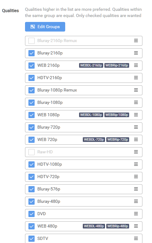

Can anyone look into these debug files and advise me on what is going on? This isn’t a terrible issue but I have noticed Sonarr occasionally doing this. For the record, in case this is needed, here is my quality profile for this show:

  1. I don’t see the season packs your first log, so it’s imposible to say why they weren’t included.
  2. While seeders is eventually used, it’s pretty low on the list Sonarr FAQ | Servarr Wiki and depending on the actual number of seeders at the time reported by both they could be close enough that Sonarr didn’t prioritize on the number of seeders.
