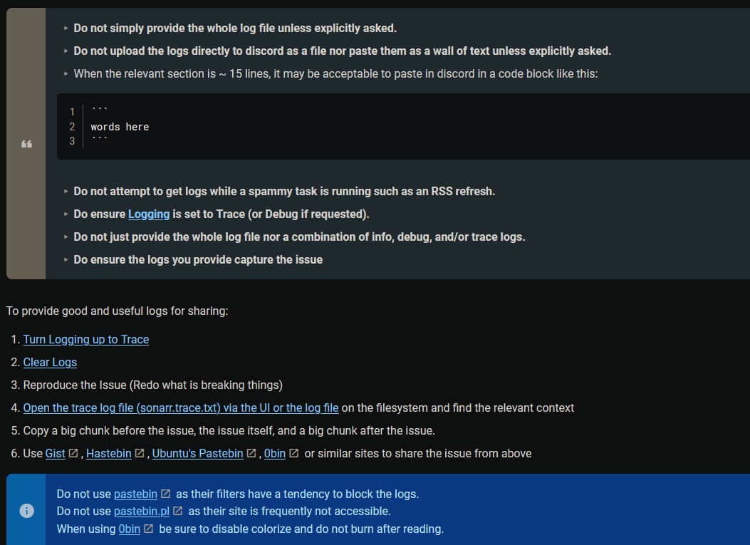

To provide good and useful logs for sharing:
  1. Turn Logging up to Trace
  2. Clear Logs
  3. Reproduce the Issue (Redo what is breaking things)
  4. Open the trace log file (sonarr.trace.txt) via the UI or the log file on the filesystem and find the relevant context
  5. Copy a big chunk before the issue, the issue itself, and a big chunk after the issue.
  6. Use Gist, Hastebin, Ubuntu’s Pastebin, 0bin or similar sites to share the issue from above
