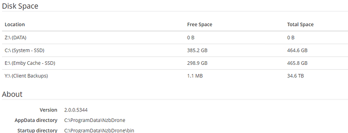

Sonarr is showing zero disk space and therefore refuses to process downloaded files.
Windows is showing 2.97TB free
Volumes are local (not mounted), however, I am using Drivepool to amalgamate volumes together.

Sonarr seems to show 0 drive size as well as space

Can you take a screenshot of that same screen i did? “System” on the left…
Thanks for your reply.
It’s a strange issue as I have no problems seeing space on my second drivepool volume (named Y:\ client backups)
