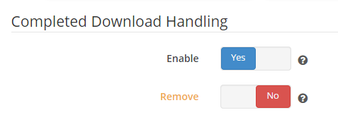

Just an update here. I enabled CDH, then toggled the “Remove” option to NO, so that Sonarr doesn’t remove the imported downloads from download client history.
This was the only change I made, I did not change the Drone Factory directory.
I then manually triggered a download to start from Sonarr on an old episode which was never downloaded. It downloaded correctly, and was then moved to the correct folder corresponding to the TV series. And now the History IS still showing in SABnzbd.
If I read your above messages correctly, by leaving the Drone Factory directory unchanged… CDH isn’t even being used. But making these 2 settings changes did seem to solve the missing History at the very least.
Here’s a screenshot showing current settings: http://i.imgur.com/chRvx9R.png

Wait… was “Remove” set to “YES” before?
Markus - yes, the Remove setting was set to YES before making the change. However I never had CDH enabled before, so I didn’t have access to this setting until just making this change to enable CDH.
And I did not muck with those settings previously, this would have been the first time I ever touched the Remove setting.
