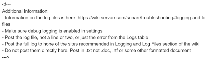

Those logs are info logs which are almost always useless for debugging. What in the forum template was unclear about requiring debug logs and how to get them?

What was not clear in the post template?
https://wiki.servarr.com/sonarr/troubleshooting#logging-and-log-files
see the download troubleshooting article on the same page.
