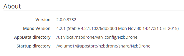

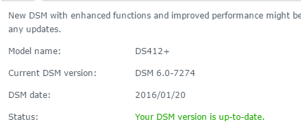

Sonarr works fine for me on DSM 6.0-7274 installed from SynoCommunity. I don’t think it’s something wrong with the package from SynoCommunity but possibly something environmental. I didn’t have Sonarr installed when I upgraded to 6.0 I was using Sickbeard then migrated to Sonarr after upgrading to 6.0.
