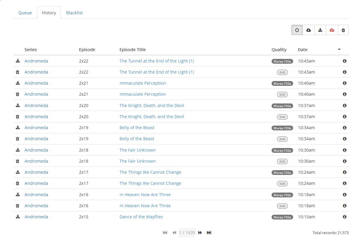

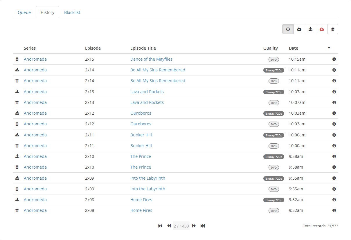

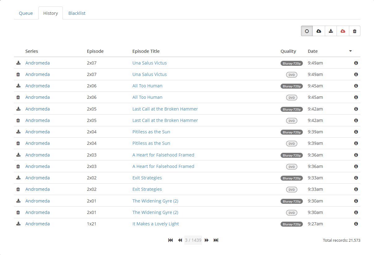

3. Both Sonarr (nzbtonzbdrone script) and SickGear are pointed towards The Drone Factory folder and detects the files. The theme here is who has the quickest draw in town? There’s been times when SickGear would import first but for the most part Sonarr takes care of it. If Sonarr wins then my files get imported to my main TV Series directory and SickGear will handle the extra’s during it’s next scan. If SickGear win then it will takes care of the subs (if needed), metadata, notifications during import to my main TV Series directory, and cleanup of any leftover files and folders shortly after. Active scans of the main TV Series directory are triggered automatically based on set intervals, and all shows are monitored for any necessary updates. This includes series info, folder creations, metadata, updated subs, renames, and general housekeeping chores. In Sonarr I’ve disabled renaming, and metadata support.

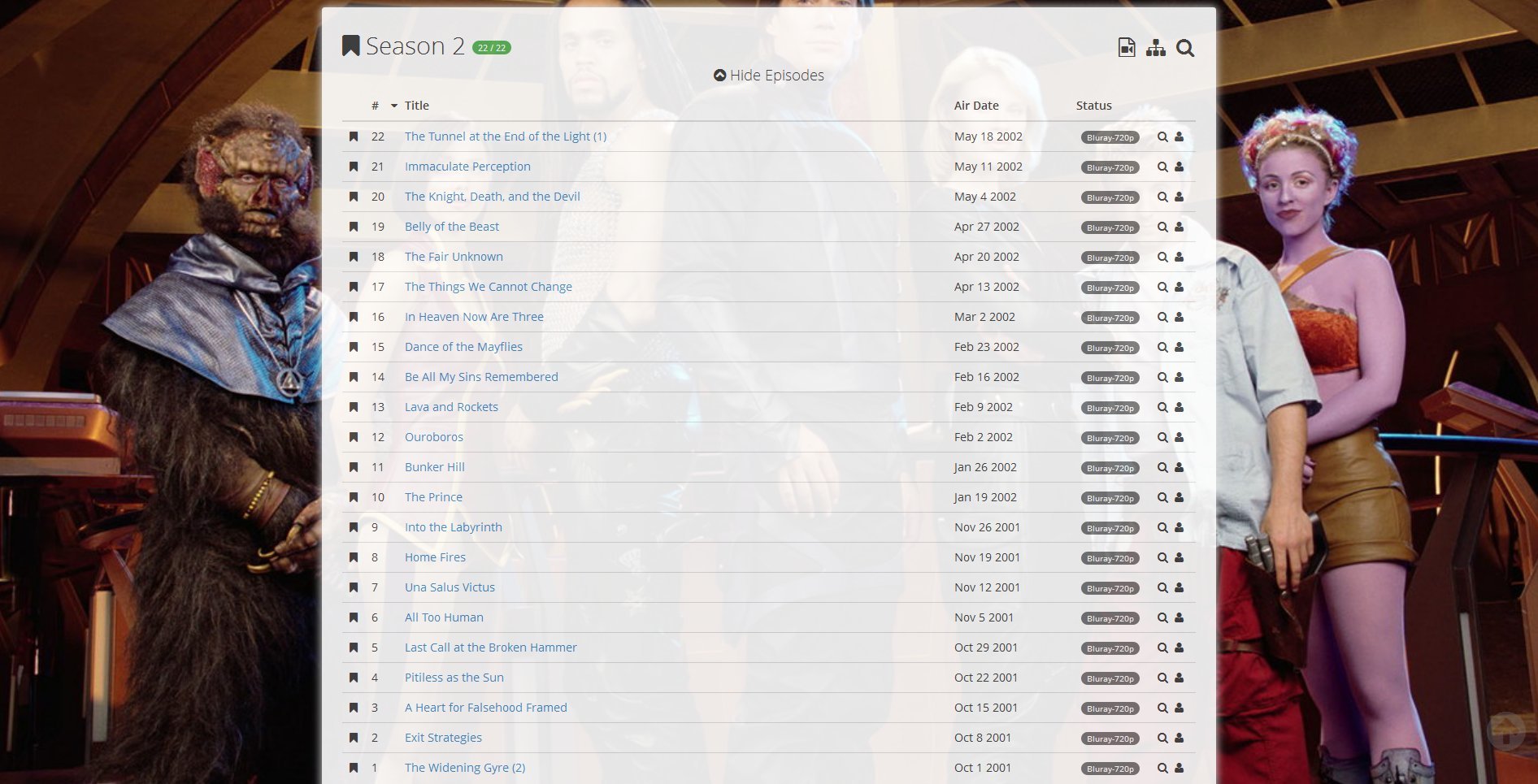

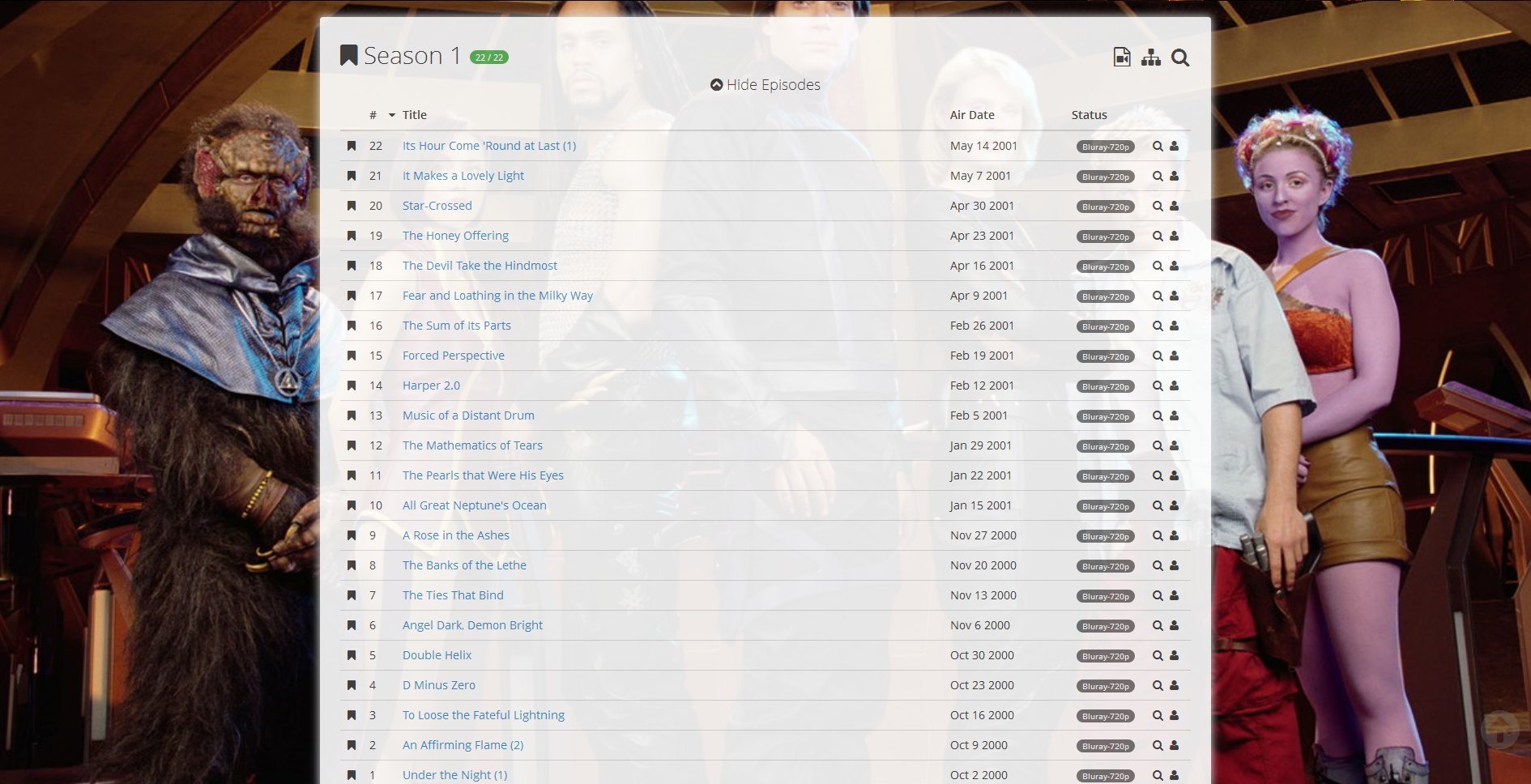

4. Sonarr’s calendar is green across the board meaning all of my shows for that week have been completed and imported. SickGear’s calendar reads the same, as well as each series episode grid. Jobs completed! Here are a few light examples of what the SickGear logs produce during an import or in general.
