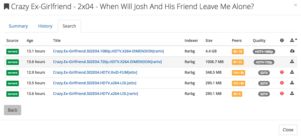

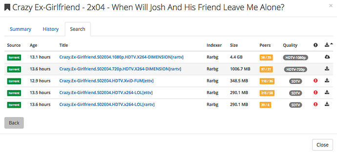

New TV show torrents aren’t being added to Deluge and I don’t know why. In every other way Sonarr seems to be talking with Deluge and it’s managing finished downloads.
For example Sonarr searched for the newest episode of Crazy Ex-Girlfriend S02E04:
Searching 1 indexers for [Crazy Ex-Girlfriend : S02E04]

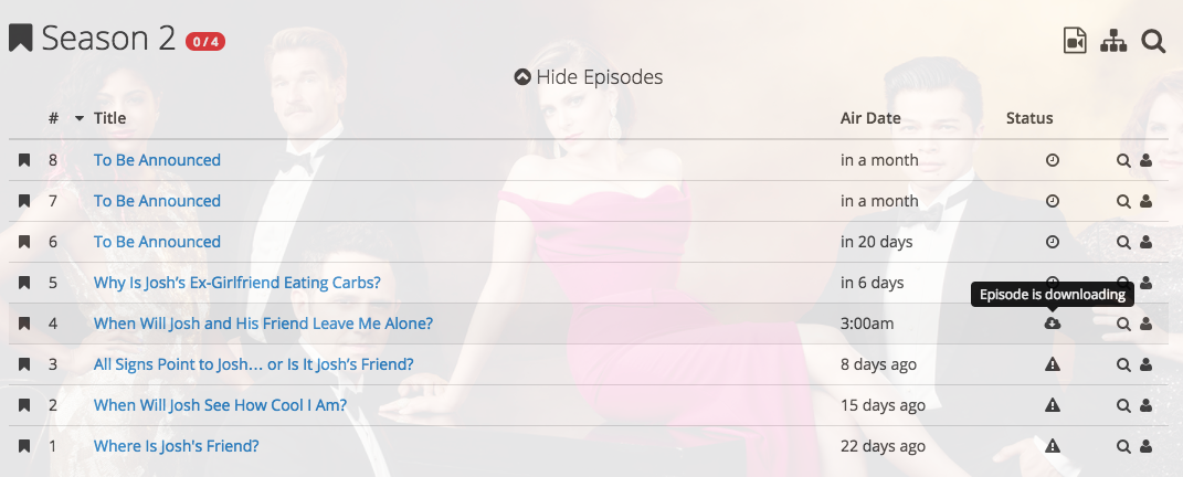

After the search I can see the cloud symbol & when I hover over it it says “Episode is downloading” except in Deluge the torrent never shows up. But when I do a manual search and click on adding one of the episode versions that show up it does show up in Deluge.
Any ideas what could be going wrong here?
