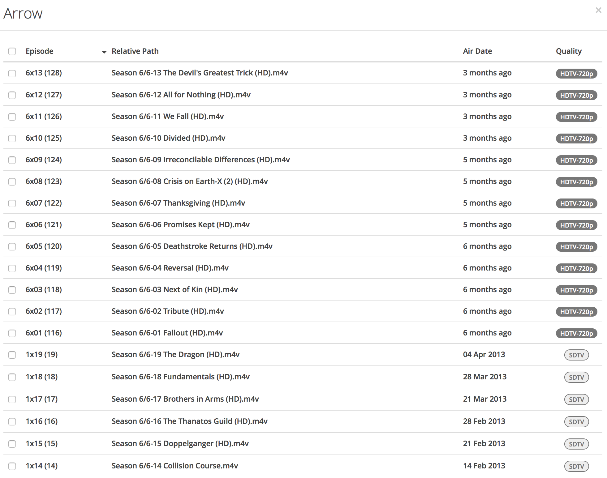

Description of issue: About 3 months ago Sonarr began confusing files it’s identifying current season episodes as being from Season 1.
For example Sonarr is reading S06E14 as being S01E14 - as per screenshot.
This is happening for all series which have multiple seasons and have files added after this time.
Wondering if something changed in a recent update about how Sonarr is reading file names/paths.
Please note that the naming convention is due to iTunes automatic organisation, however Sonarr had been correctly identifying epispdes with this same naming convention until a few months ago - so what’s changed?

So, if I understand correctly: you point sonarr to a directory that holds your sorted media, and you then let iTunes rename those files?
I can’t see that going well. iTunes renames, sonarr periodically rescans the folder, sees some files it doesn’t know about (since they have been renamed), tries to guess what file they are…
If you would replicate the naming convention that iTunes uses in your sonarr media renaming settings, and don’t let iTunes touch that directory (only for reading) that might go better. If sonarr does the renaming, the file is linked in its database to the correct episode.

I have figured out a workaround a short time ago, I have been able to get iTunes to keep the files where they were before but to let me control the naming convention.
Sonnar is still scanning the iTunes Library but not getting confused… still think Sonarr is a bit too rigid in what it wants to see in naming, it also got confused by a couple of episodes which had numbers in the file name, but a little bit of tweaking sorted that.

Oh, I knew that naming convention was the preferred option, the challenge was how to stop iTunes from overwriting and imposing naming convention upon your files… and still make sure that it’s keeping the media files in a place which iTunes is happy with for Sync’ing to other devices.
I was able to name the files “S{season:00}-E{episode:00}” and then if I dragged and dropped them into iTunes it would change it “{season}-{episode:00}”.
It comes down to the understanding of these 2 settings… the first one is the problem not the second one though.
When you tick Keep iTunes Media folder organised it keeps the files in folders based on TV Show and Season. The Season, Episode and Name if the file are applied based on what the MetaData in iTunes is set to and it will move the files around the folders and rename the files based on how you update or edit that data in iTunes.
If you untick Keep iTunes Media folder organised it actually still adds the files into folders based on TV Show and Season, but does not impose it’s own file name convention, which that’s not really how it reads (well thats not how I read it anyway). I got the impression it was going to add them into a flat/root media directory with no organisation at all.
