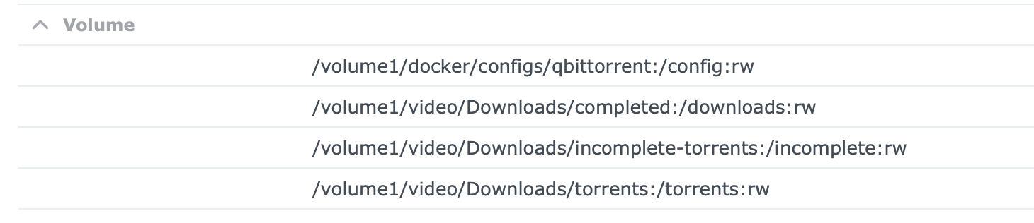

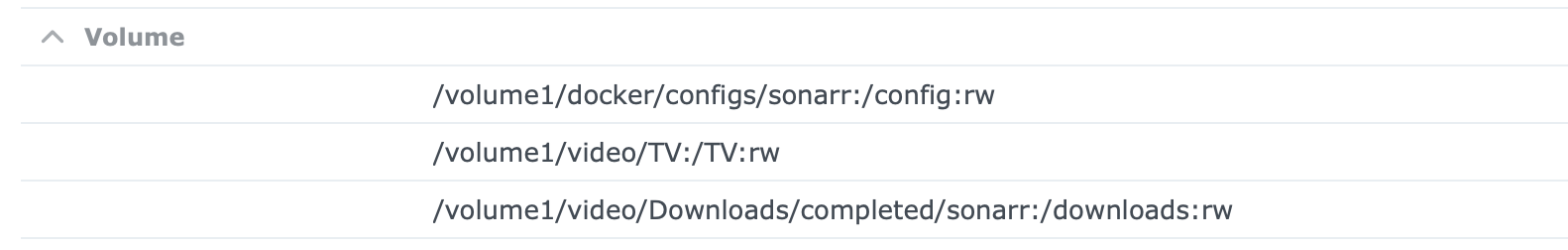

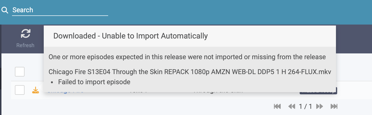

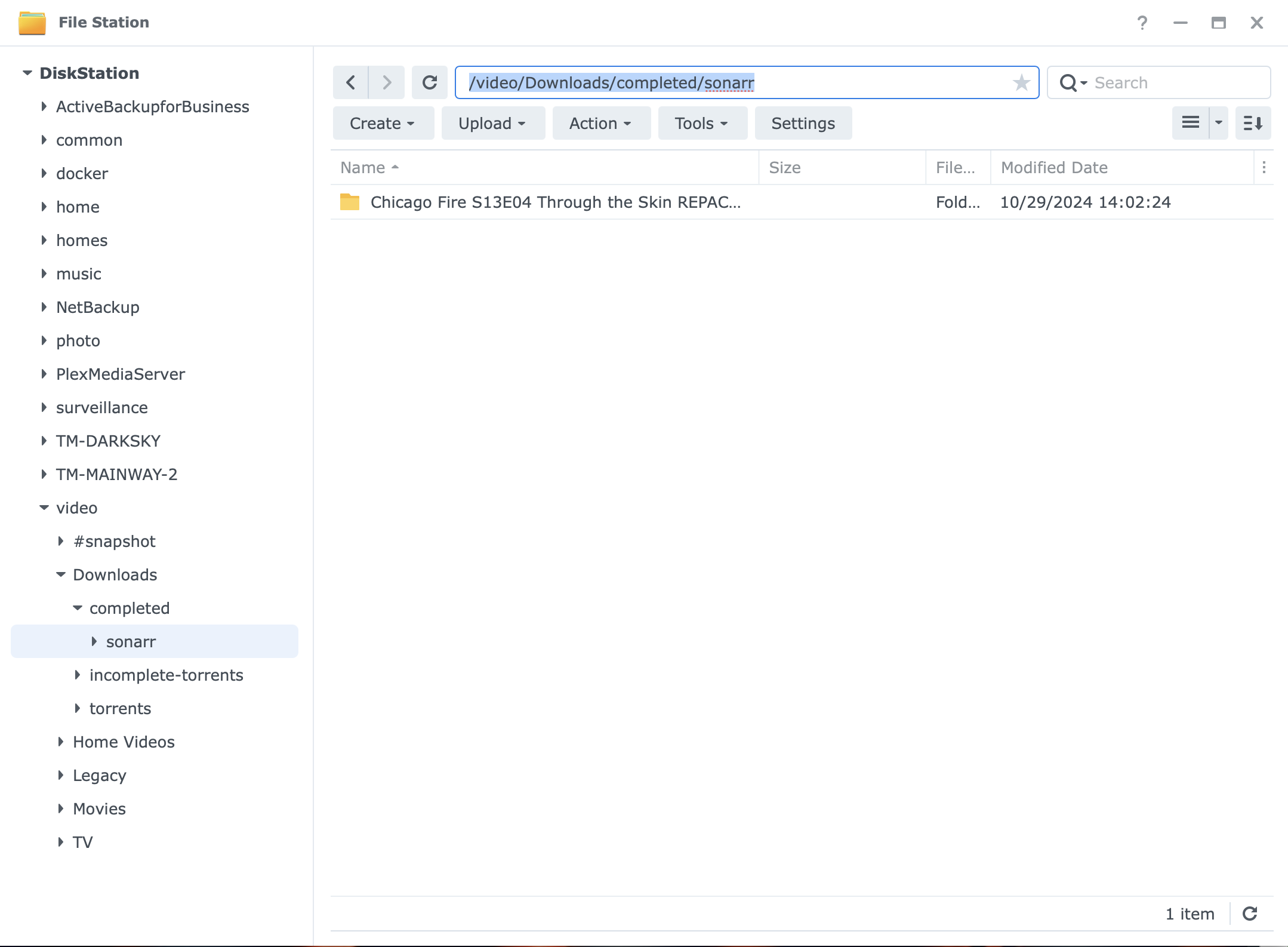

Qbittorrent successfully downloads the episode and puts it in the /video/Downloads/completed/sonarr folder, but won’t import it into my video/TV folder. The error in Sonarr says “No files found are eligible for import in /downloads/sonarr/Chicago…” (see attached). Am I missing something with mappings? Because I can’t figure this out (I’ll recheck permissions) I have attached my NAS file structure, and the container volume mappings to see if I’ve confused something.
Error in Sonarr:
Synology NAS folder structure:
Qbittorrent docker container volume mapping:
Sonarr docker container volume mapping:

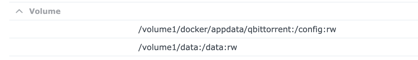

On your advice I scoured through the Trash Guides. Consequently I have revamped my NAS folder structure to have everything in /data (i.e. /data/media, /data/torrents). I don’t use usenet. See below:
I have adjusted the mappings in the two docker containers to what I think the Trash Guides recommend. Note there is no guide on qbittorrent container volume mapping, so I’ve guessed.
qbittorrent container volume mapping:

I’d like to confirm that I have the mappings correct. Something still isn’t quite right because I have a new error in sonarr that says “Unable to Import Automatically”. In sonarr settings I set the root folder to /data/media/tv.
Based on the guides I think I’m almost there, just need a bit of advice on where I am going wrong.
It seems that I have fixed it.
I changed the qbittorrent container’s volume to /data/torrents:/data/torrents. This way I don’t have qbittorent with access to the entire /data directory (unnecessarily - based on the principle of least privilage). Within the qbittorent application settings, the default save path is set to /data/torrents. Sonnar seems to find this just fine and import the completed download into /data/media/tv.
