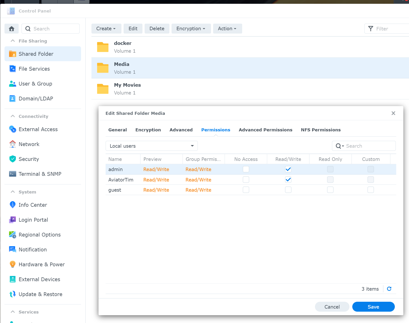

I’m not sure what user Sonarr is running as when intalled via Docker. I’ve tried turing on Read/Write for almost every user under Control Panel/Shared folder. The local users…
I probably have turned on a lot of permissions that aren’t required trying to fix the Sonarr problem so any feedback on what I can safely turn back off is additionally appreciated.

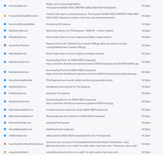

2022-02-22 14:44:59.0|Warn|SonarrErrorPipeline|Invalid request Validation failed:
– : Unable to connect to indexer, check the log for more details
2022-02-22 14:46:00.2|Warn|ArgumentValidator|value [Media/Torrents/Downloading] is not a valid *nix path. paths must start with /
2022-02-22 14:46:00.2|Error|DownloadClientRootFolderCheck|Unknown error occured in DownloadClientRootFolderCheck HealthCheck
[v3.0.6.1342] System.ArgumentException: value [Media/Torrents/Downloading] is not a valid *nix path. paths must start with /
Parameter name: path
at NzbDrone.Common.EnsureThat.EnsureStringExtensions.IsValidPath (NzbDrone.Common.EnsureThat.Param1[T] param) [0x00050] in M:\BuildAgent\work\63739567f01dbcc2\src\NzbDrone.Common\EnsureThat\EnsureStringExtensions.cs:109 at NzbDrone.Common.Extensions.PathExtensions.CleanFilePath (System.String path) [0x00047] in M:\BuildAgent\work\63739567f01dbcc2\src\NzbDrone.Common\Extensions\PathExtensions.cs:33 at NzbDrone.Common.Extensions.PathExtensions.PathEquals (System.String firstPath, System.String secondPath, System.Nullable1[T] comparison) [0x00027] in M:\BuildAgent\work\63739567f01dbcc2\src\NzbDrone.Common\Extensions\PathExtensions.cs:58
at NzbDrone.Core.HealthCheck.Checks.DownloadClientRootFolderCheck+<>c__DisplayClass4_0.b__0 (NzbDrone.Core.RootFolders.RootFolder r) [0x00000] in M:\BuildAgent\work\63739567f01dbcc2\src\NzbDrone.Core\HealthCheck\Checks\DownloadClientRootFolderCheck.cs:48
at System.Linq.Enumerable.Any[TSource] (System.Collections.Generic.IEnumerable1[T] source, System.Func2[T,TResult] predicate) [0x0002c] in <798dd06330af4ca3886d7d2be5573af7>:0
at NzbDrone.Core.HealthCheck.Checks.DownloadClientRootFolderCheck.Check () [0x0005c] in M:\BuildAgent\work\63739567f01dbcc2\src\NzbDrone.Core\HealthCheck\Checks\DownloadClientRootFolderCheck.cs:48
2022-02-22 15:06:18.0|Info|NzbSearchService|Searching indexers for [The Expanse : S06E02]. 1 active indexers
2022-02-22 15:06:26.3|Info|DownloadDecisionMaker|Processing 30 releases
2022-02-22 15:06:27.6|Info|DownloadService|Report sent to Download Station. The Expanse S06E02 1080p WEB H264 GLHF
2022-02-22 15:06:27.6|Info|EpisodeSearchService|Episode search completed. 1 reports downloaded.
2022-02-22 15:06:32.8|Error|DownloadedEpisodesImportService|Import failed, path does not exist or is not accessible by Sonarr: /volume1/Media/Torrents/Downloading/The.Expanse.S06E01.REAL.PROPER.1080p.WEB.H264-GGEZ[rarbg]. Ensure the path exists and the user running Sonarr has the correct permissions to access this file/folder
2022-02-22 15:07:58.8|Error|DownloadedEpisodesImportService|Import failed, path does not exist or is not accessible by Sonarr: /volume1/Media/Torrents/Downloading/The.Expanse.S06E01.REAL.PROPER.1080p.WEB.H264-GGEZ[rarbg]. Ensure the path exists and the user running Sonarr has the correct permissions to access this file/folder

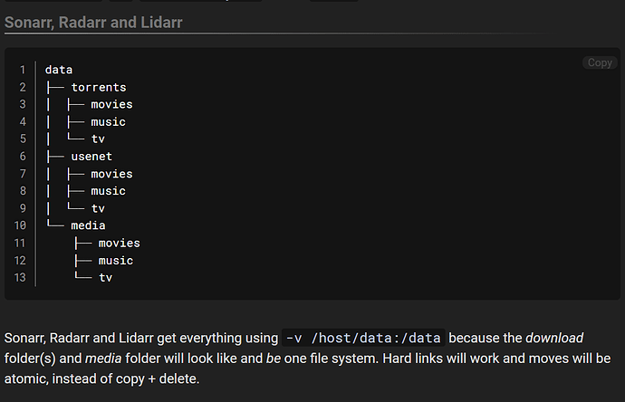

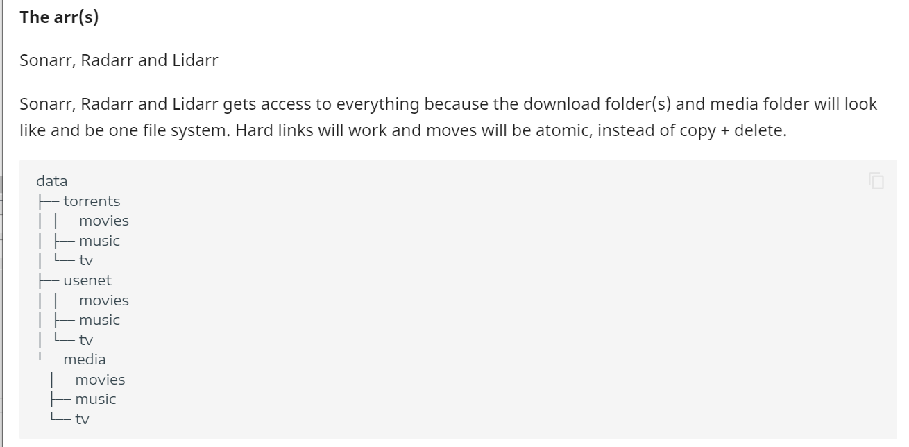

Thank you for sharing that link. It doesn’t give a suggested path structure but this article (https://trash-guides.info/How-to-setup-for/Docker/) that was shared in another forum suggests this path structure
Once I updated the structure according to the article, I no longer get the “import failed: path does not exists or is not accessible by Sonarr”. However, it still fails to move the complete download from the download folder and still gives error message. Now the error messages say this instead…

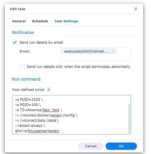

The article says to update the PUID, PGID, TZ and two volumes to match your setup. I’m guessing I messed up one of those settings? Here’s what I put for those values…
docker run -d --name=sonarr
-p 8989:8989
-e PUID=1026
-e PGID=100
-e TZ=America/New_York
-v /volume1/docker/sonarr:/config
-v /volume1/media:/tv
-v /volume1/data/torrents:/downloads
–restart always
The part that is not clear is whether the problem arises from passing the mapping instructions incorrectly in the initial installation or whether the virtual paths are mapped correctly but there is a permissions problem.
The website says to change the format to match your specific setup. To answer your question, specifically, are the three lines BELOW the TZ=America/New_York paramater formatted correctly for my system configuration.
I figure either those are incorrect (perhaps a name a space between “volume” and “1”? maybe it should say “host” instead of “volume1”?). Is one of those formats wrong?
To try to be even more clear, it’s not clear to me why the file structure in the wiki instructions is data/torrents/tv but the path mapping only references host/data. Does referencing the data folder give Sonnarr access to all the subfolders in it (i.e. movies, music, and tv)? If Sonarr doesn’t need to be pointed at the specific tv subfolder, why is it necessary to reference the data folder at all, why not just reference the host folder and let Sonarr sort out the subfolders?
It’s not clear to me why the instructions suggest to setup of movies, music and tv subfolders if the setup parameters passed to Sonarr only reference the data folder
The reason is that inside docker, each mount point is a separate disk, for simplicity’s sake.
You’ll be doing slow ass file copies instead of instant moves, when sonarr wants to import a completed download. It’s super inefficient.
Edit: it’s also waaayyy easier to just give all your dockers the same /data mount, and you won’t have to fiddle with remote path mappings (assuming your download client is a docker container as well, which is not clear to me).

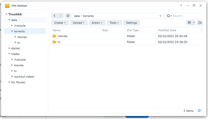

Thank you for jumping in and trying to help Thirrian. I see what you’re saying. The instructions have “media” inside the “data” folder, whereas I have media outside the data folder. I was trying to to use “data” only for temporary/transitional files which is why I tried to separate out permanent/keep files in media.
That being said, does “media” HAVE TO be under data for Sonarr to work? As long as I pass the right parameters in the initial setup…
To try to ask more clearly, do I have to revamp my file architecture for it to work? Or do I just need to correctly tell Sonarr where each file type resides?

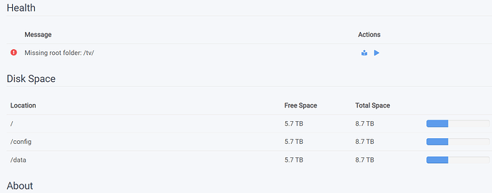

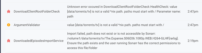

I removed the line referencing TV like I think you’re saying. When I do that, I get an additional System>Status message which wasn’t there before, “Missing root folder: /tv/”
I’m using Download Station because I’m familiar with it. It is NOT running in a Docker container. Should it be? Is it even available to run inside a container?
I’m beating my head against the wall trying to determine the exact nature of the problem here. Then again, if I understood the nature of the problem, I guess there wouldn’t be a problem. I would just fix it. LOL.
Anyway, I’m guess there are two problem in this screen shot here. Perhaps a path problem that causes the first two error message and an additional permissions problem that causes the third error message?
I assume there’s some format error with the two lines above "–restart always " which causes the first two error messages? If so, can someone please help me with what the correct format would be
Next, my guess is the last error message is a permissions problem because the path that Sonarr says “does not exist or is not accessible by Sonarr” definitely does exist so I presume the problem is not being accessible to Sonarr. If so, how do I fix that?
