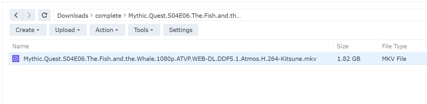

It’s telling us that it can’t determine if the file is a sample, so let’s go look.

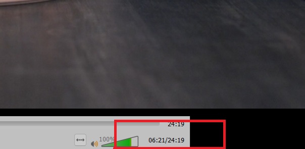

1.82gb MKV file doesn’t look like a sample, but let’s download that file to my PC and play it in VLC to be sure.
mq2
6 minutes and 21 seconds into a 24 minute, 19 second episode. Clearly not a sample.

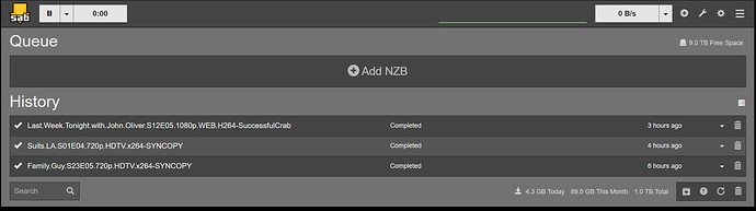

Well, as expected, all 3 of my downloads failed last night with “No files found eligible for import”.
For the record, the initial failures were when I had Sonarr installed via the Community Package Manager.
This latest batch of failures are from Sonarr installed via Docker.
Here’s confirmation that SABnzbd successfully downloaded all three …
Permissions-wise, the /volume1/Downloads/complete folder’s “System Internal User” permissions are enabled for “sc_sonarr” and “sc_sabnzbd”.
The actual folder from the command line is 700 with an ACL “+” sign.
As an example, this is what the log file says about the Family Guy episode
“0 video files were found in /downloads/Family.Guy.S23E05.720p.HDTV.x264-SYNCOPY”
Which, of course, is incorrect as the MKV file has been correctly downloaded and is sitting in that exact folder.
