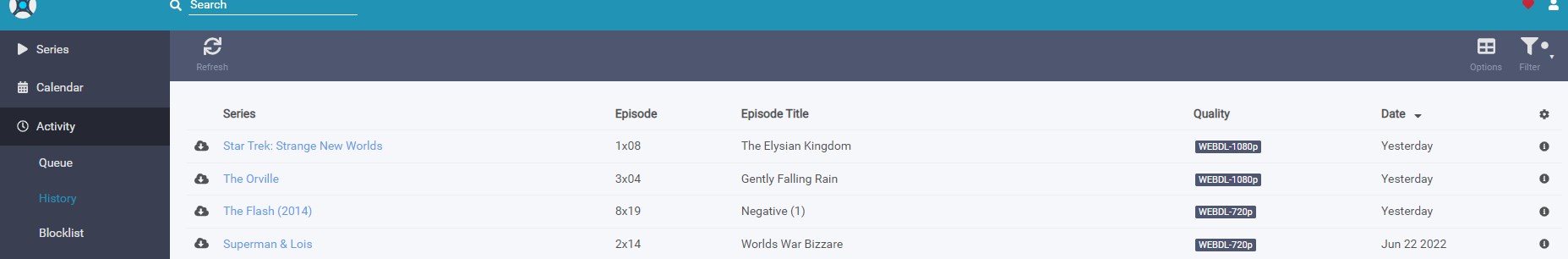

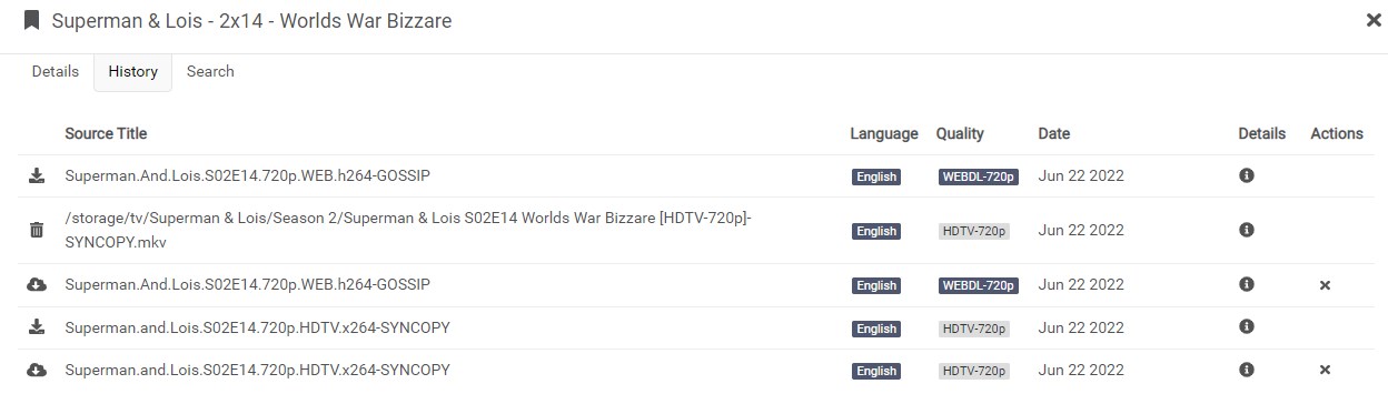

I found another case of this weird behaviour, this time with different downloaded files of the same episode:
History shows one file that should be there, the previously downloaded HDTV 720p release was removed before importing the WEBDL 720p release (if the delete failed Sonarr wouldn’t import the replacement).
The two files there aren’t the same so I don’t think removed quality and release group will do anything other than have the file names conflict which might prevent the duplicates, but could also just cause whatever is trying to also import files to fail thus “fixing” the problem.
