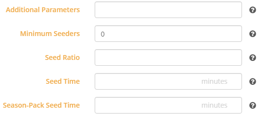

also, all your returns in sonarr have peers, the two in the first image that dont show do not appear to have any. have you set a requirement for X number of peers?
Number of peers are 0
