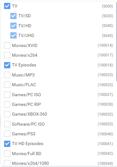

I’m trying to download The Witcher season 2, I added the serie and started a search for the season pack for season 2 but nothing was found. The problem is that there are several on at least one of the indexer I have added on my Sonarr (refer to this link).
The indexer is that should be a match is RARBG, set up through Jackett. The test on both Jackett and Sonarr of the indexer has positive result, the indexer is activated for both interactive and automatic search and I selected all the categories relative to tv shows (see attached photo).
In the logs (debug level) there is no error, just messages that say that no indexer found any result for the current search.
I think I may have set up the indexer wrong, can anyone help me set it up correctly?
