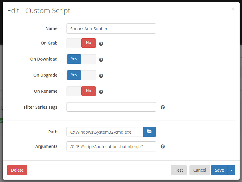

  5. Setup the custom script in Sonarr (Sonarr → Settings → Connect → + → Custom Script)
    Single language:
    Multiple languages:
    5a. Name: Sonarr AutoSubber (or whatever you fancy)
    5b. On Grab: No, On Download: Yes, On Upgrade: Yes, On Rename: No
    5c. Path: C:\Windows\System32\cmd.exe
    5d. Arguments: /C “C:\FULL-PATH-TO\autosubber.bat [2-letter ISO 639-1 language code(s)]” (In my case: /C “E:\Scripts\autosubber.bat nl”)
  6. Save the custom script

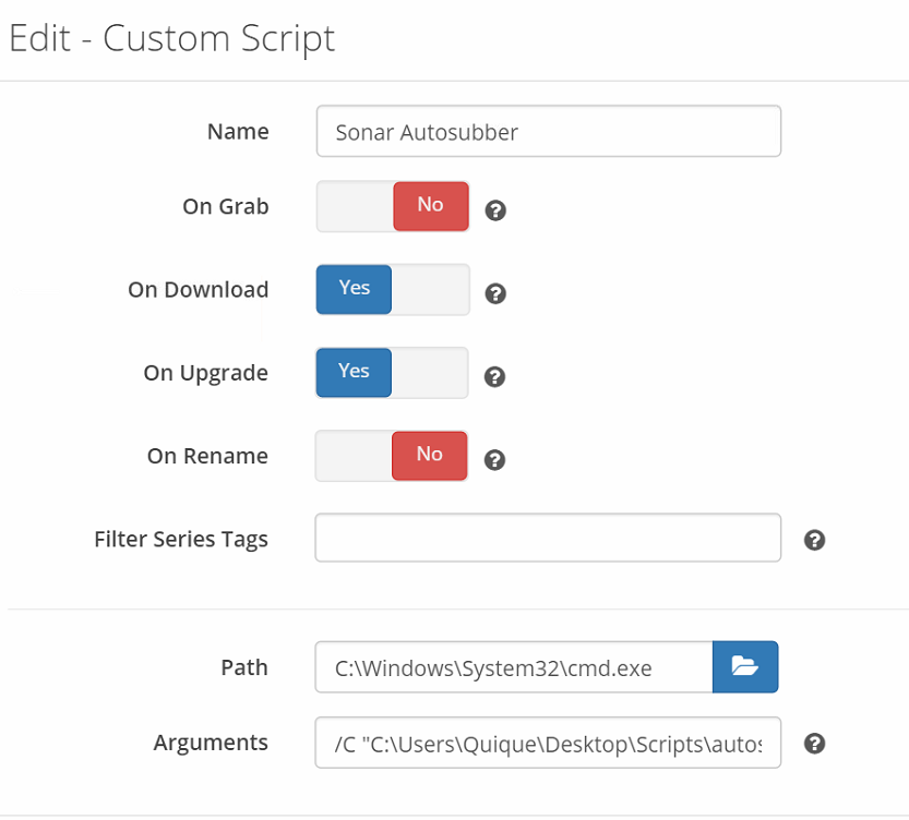

Hi @Zignature is working but… I have my sonarr configured to move episodes after download it and your script downloads the subtitle on the download folder and is never moved to the series folder :frowning: any idea?
You need to adapt the script that moves your episodes to include the subtitle(s).
Can you share the script that moves the episodes?
If you use the latest version of the AutoSubber it would probably be possible to add the moving part to it since Filebot is able to move files as well.
I use the option that you have with sonarr
If you let Sonarr move your episodes, it sounds to me you’re getting the subtitles “On Grab”.
You need to get the subtitles “On Download” and “On Upgrade”. Check out the screenshots for the correct settings.
This was my config:
And now:
is it correct?
Should work now :slight_smile:
nothing changed :frowning:
