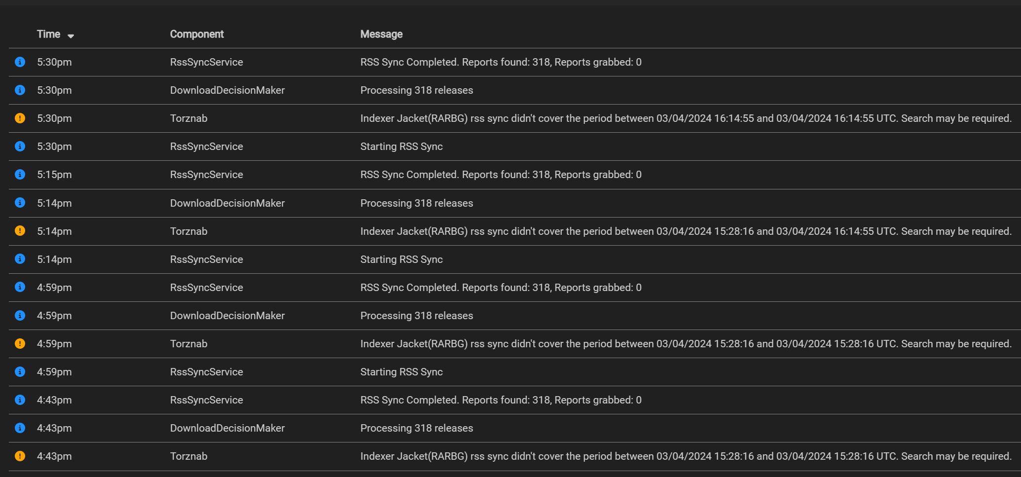

Sonarr.trace.42.txt seems to be the only one of use there, and it just shows all results from TheRARBG being rejected, either because there’s no matching series or they’re films or porn.
I’d suggest you configure more indexers, as clearly just those 5 (and only 2 for non-anime TV) aren’t cutting it. TorrentGalaxy, ShowRSS, and EZTV should cover it, but if you want a couple others then throw in 1337x and GloDLS too.
Take a look at your configured categories for the indexer, as there should only be TV and anime results, not films and porn. If you’re just returning everything then there’s a good chance that some TV and anime uploads may be missed as they won’t be on the first page of 40 results.

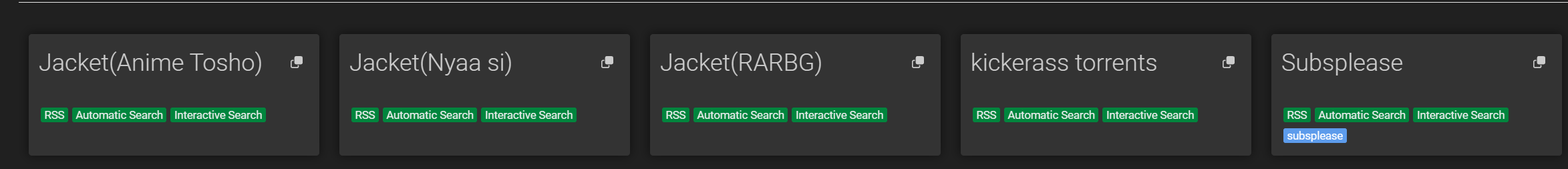

Oke, so i’ve updated my existing indexers so the ones for TV shows only have TV selected for main category & anime for the anime category. I’ve also added 1 indexer (TorrentGalaxy, ShowRSS), EZTV & 1337x doen’t work properly.
Although TorrentGalaxy also shows signs of issues. Every now and then I get the following event message:
I got 7 indexers in total now. 3 for Anime and 4 for TV shows. Plus I also checked the event nog and there is now no warnings for RARBG anymore after the change.
