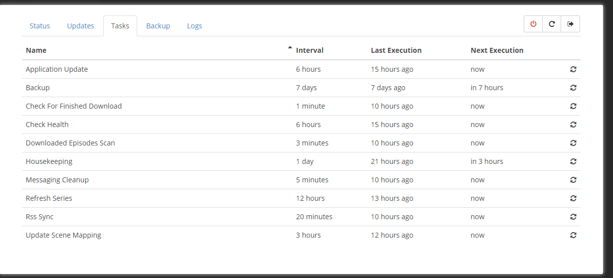

I think i had mine working for a few days after the recent update to fix this issue, looks like back again for me.

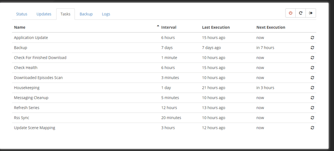

I realized when episodes weren’t downloading, then i checked my Tasks tab and it showed every task hadn’t been completed in over a day.
I then copy pasted my first log, enabled trace and restarted. Then followed it up with another log in case you needed more.

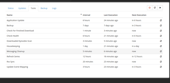

@Taloth As to frequency, with me it happens at every restart. Tasks run once and never again, this includes tasks set to run once a minute.
