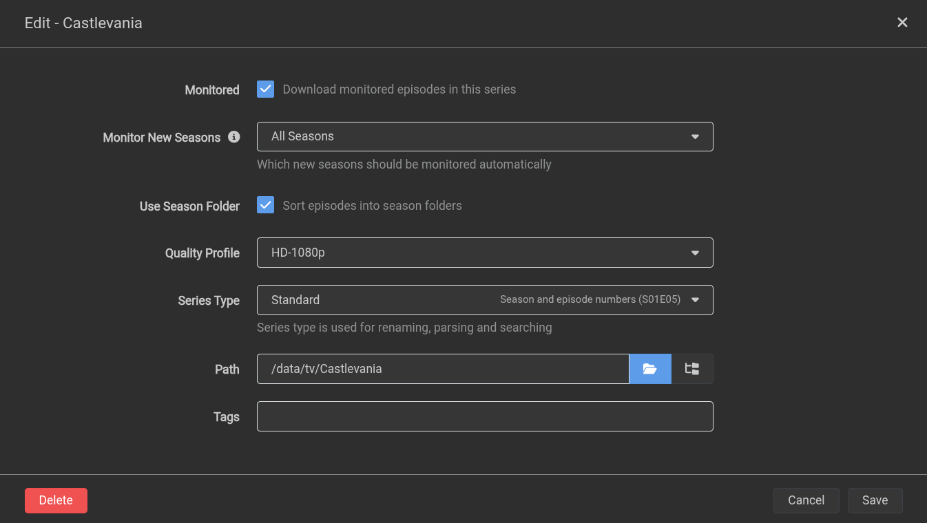

In this example, the show Castlevania is mapped to /data/tv/Castlevania.
I can see we have some files in the directory now, although they’re not organized into season folders;

If I try to organize the existing files into season folders in the UI, I get an error:
Failed to rename file /data/tv/Castlevania/Castlevania.S01E01.Witchbottle.mkv: Access to the path '/data/tv/Castlevania' is denied.
I even created the Season 1 folder by hand and gave it full permissions:
root@f0c80f43a3a2:/data/tv/Castlevania# ls -lah Season*
'Season 1':
total 24K
drwxrwxrwx+ 2 501 root 4.0K May 21 10:53 .
drwxrwxrwx+ 7 501 root  12K May 21 10:53 ..
Yet, I get the same “permission denied” error.
