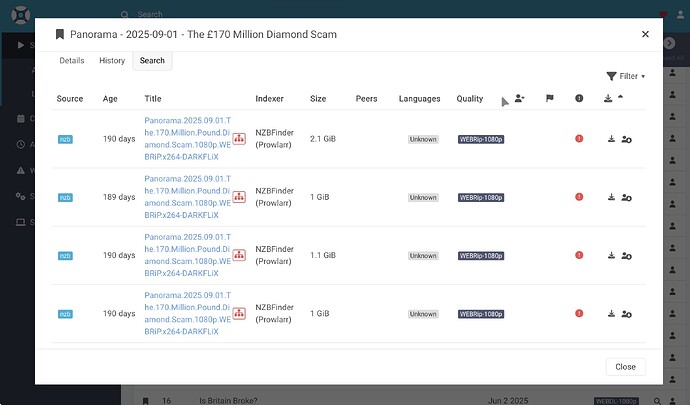

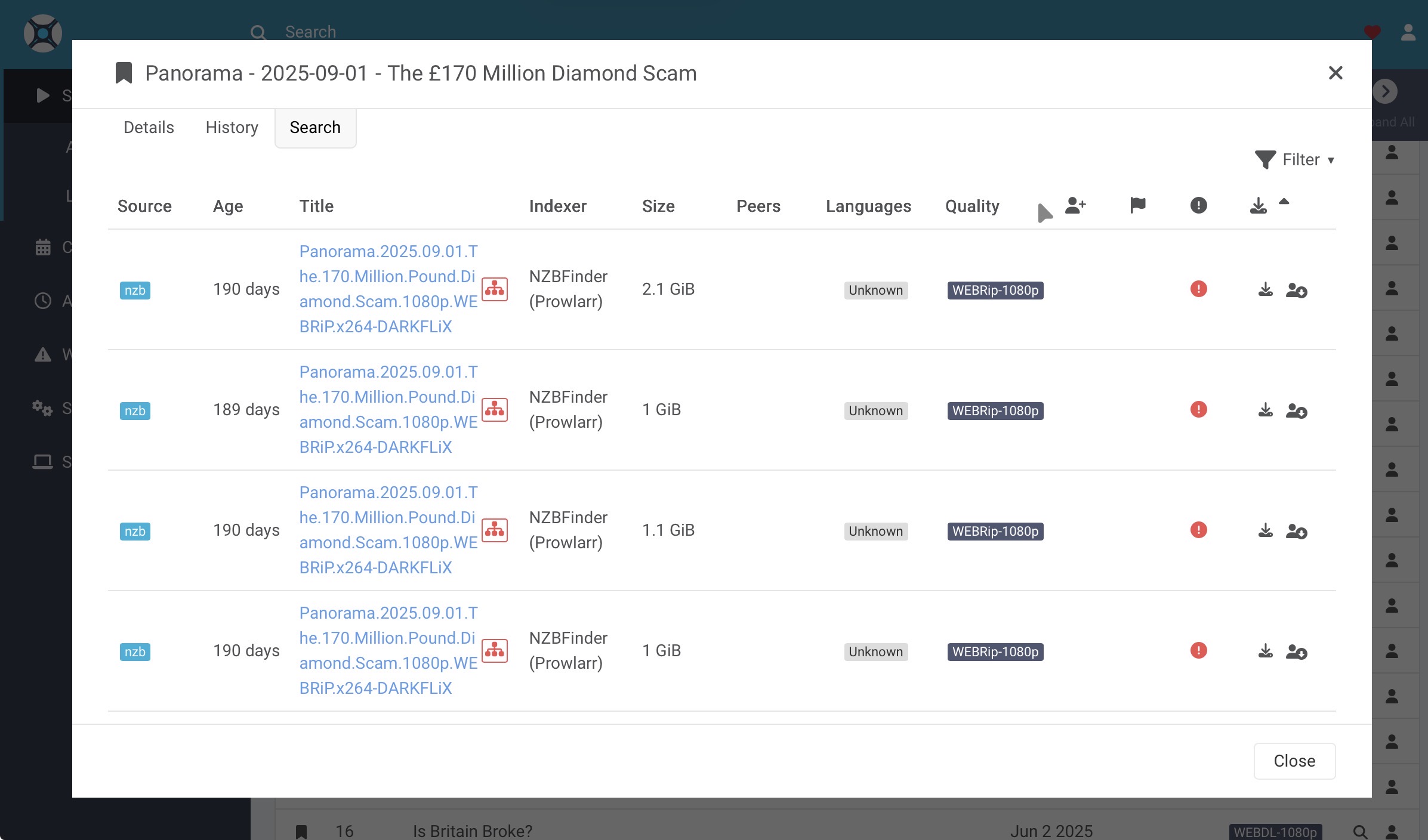

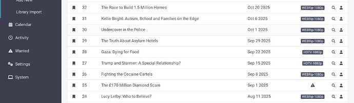

@markus101 that’s spot on. The episode is never downloaded to begin with and an exclamation mark is shown next to it. When I launch interactive search it reveals the episodes shown are rejected due to unknown series/episode, but has successfully pulled the correct episodes.
Below is an example of this:-

As long as the series type is set to daily (and it looks like it is) that looks like it should work. Debug/trace logs would be good to see what’s gong on there (when it’s sitting in the queue).
Correct, it’s set to daily.
