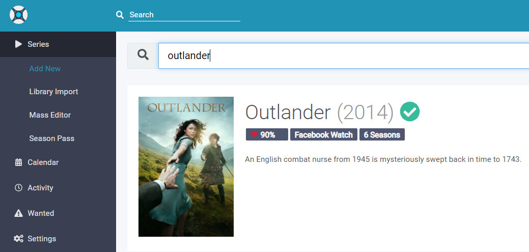

define “mapped it”. having a folder doesnt mean anything. can you see outlander as a series in sonarr?

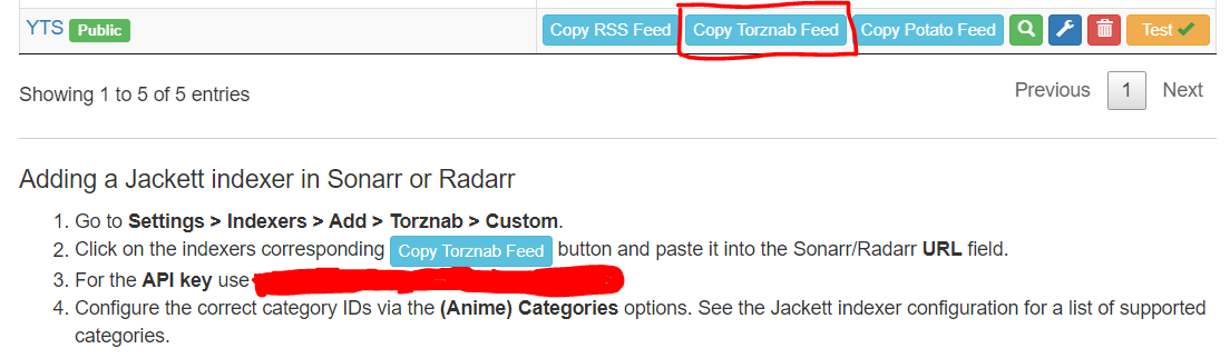

not directly, via jacket, just not using the /all link. use the specific indexer link that jackett generates for it instead. ie follow the instructions on the jackett front page about adding an indexer to sonarr.
I mean, I linked the TV Show in the Library import section to the one that shows up in the search field.

Yes the thoughts are for you to follow the directions and copy the torznab url for IPT from Jackett and paste it in as the URL for a newly created Torznab indexer in Sonarr as previously instructed several times.
API path is /api and shouldn’t be changed

i’ve never had to use the import function so im not sure what it does, but essentially can you see the show in sonarr, either from the series listing page, or if you search for the show in sonarr (not an indexer)
in terms of jackett, you need to go to your jackett web page and follow the instructions there - just be careful about adding an anime category if the indexer does not do anime, ie just add a normal category for normal tv
Yes, when I look for the TV Show just like you show in the screenshot and in Sonarr itself, it’ll find it:
Aah, now I get it. Initially, I used this guide: How to Configure Jackett with Sonarr on Windows in 2021 - Smart Home Pursuits. In there it shows the /all in the URL, I was struggling with what you guys meant by that, but now I do understand!
After some suggestions in this thread I tried to add Jackett by using the third option on the Jackett front page:
That resulted in the error I posted: 'Base Url' is not in the correct format.
Now that I added Jackett as you showed on the screenshot there’re no errors and everything looks good. Monday night (CET) there’s a new Outlander episode, let’s see if this fixed my issue from the OP.
Sorry for all the confusion, you’re really helpful. I’ll keep you posted.
Yep, it worked, the /all was the culprit. Thanks, everyone.
