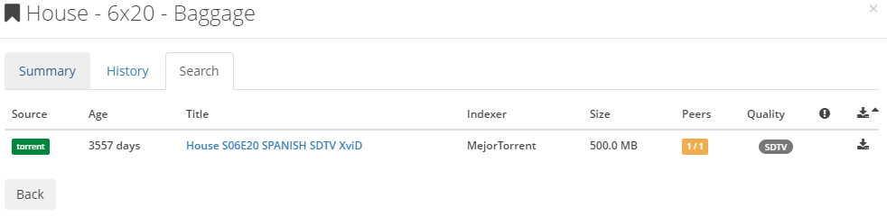

But they do not appear on “manual search”. They are monitored and missing.

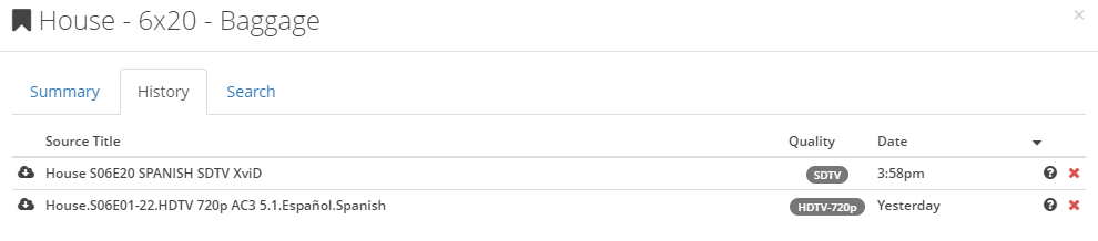

When I manual search, it only shows me some bad quality torrents and if I go to “History” tab, I can see there the good one, the one i did delete from deluge.

if they dont appear on a manual search then they dont exist on your indexer. wont matter if the search is manual or automatic, they both return the same results, manual just lets you pick.

You can go through history and follow the info links to regrab torrents manually.

Isn’t this what is happening to me? When I search again I can only see some SDTV torrents.

Yes, because your indexer isn’t returning the results you expect, Sonarr only shows what it gets back from the indexers. Either your categories aren’t what they should be for those indexers or there is something between Jackett/your indexer.
